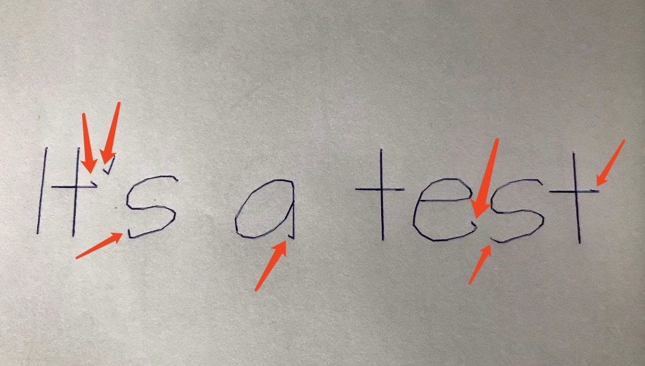

    Drawing and Gcode are created by Inkscape, it's working good except the end of lines. My drawBot uses a SG90 servo to control the pen up and down, and when the pen begins to lift up, not high enough, the next command "move" is executed at once that draws an additional trail at the end of lines.
    By now, I have to add a command "G04 P0.2" after all commands that pen being lift up.
    Is there a global delay setting for this operation?
    Sample code:
    Code:
    G01 Z-1.000000 F100.0
    G01 X112.115308 Y109.951082 Z-1.000000 F400.000000
    G01 X150.685978 Y110.289190 Z-1.000000
    G01 X129.736520 Y198.057216 Z-1.000000
    G00 Z1.000000

    OK, I'm using Inkscape extension "Gcodetools" to convert the drawing to GCODE.
    The whole process is: Inkscape --> Gcodetools --> UGS --> plotter. The process is working fine except the problem mentioned in the question.

    The SketchUcam plugin for Sketchup adds a G4 P0.1 after every servo pen movement. This forces synchronization
    with the command queue, but may not be long enough.
    You could also use the 'slow pen movement mode' which was designed for eggbots. if you move the pen too fast it breaks the egg (-: If you enter a delay it will try to move the servo slowly by outputting short movements with G4 delays between them.
    This will ensure your pen is up before moving since the last couple of moves and delays will happen after the pen leaves the paper.

    Thanks for your suggestion, David.
    The plugin inserting G4 command is similar to my manual solution, I got a message from you reply, there may not be a global setting for this. Since I haven't used Sketchup, I'll probably keep my manual approach.
