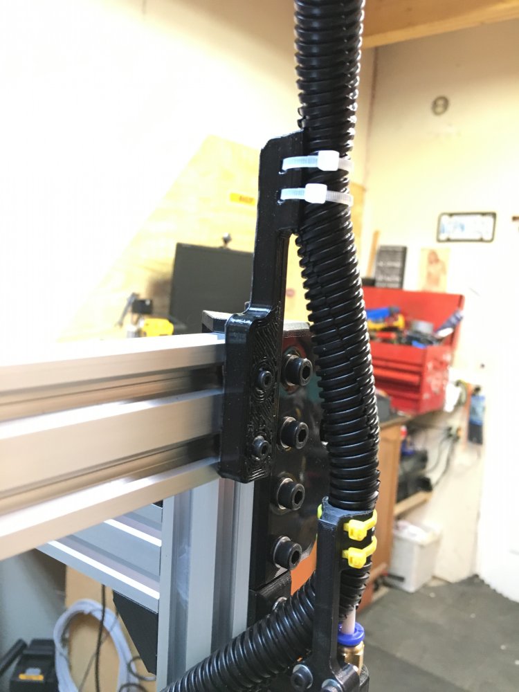

    I've figured out a bit different of a solution. I reworked a piece of the tube holder to be mounted on the end of the y-axis gantry and to accommodate the bundle and elongated it to gain a bit of clearance over the machine. It's a very crude rework, as I struggle a bit with the various design apps (123D, SketchUp ect) but it was effective as the bundle can go to the far end and back with no drooping below the gantry or binding. I'll post a pic later when I get home.

    I went uber cheap and ugly, I used rubber bands tied back to the cable chain. They work great and even trained the tube to be vertical even when not taut now.

    I noticed that's how some others were doing it, or something similar. I was just trying to stay away from the cable chain all together for the top. (no offence to all those using one) Just my own personal aesthetic preference.

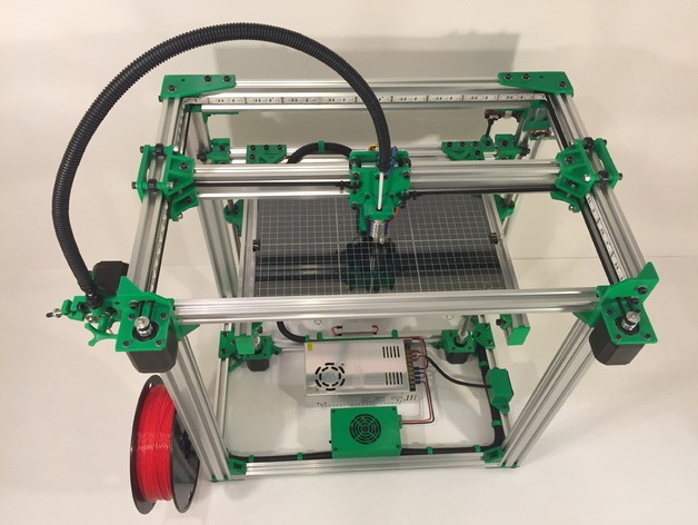

    Just wondering since I have no plans to go bowden, but is there any reason why nobody mounts it to the middle of the rear top extrusion? That is the best supported place on the build, and mounting in the middle would allow you to have the shortest tube without either having a moving extruder or having it hang overhead somehow.

    I thought about doing that, but it's access to the extruder that is important. Putting in front left is easiest access for switching out filaments.

    I would have to agree as I considered that too, but access to filament and a larger depth of footprint made me change my mind, even though I was running direct and not bowden.

    One of the simplest and cleanest ways to manage wiring to the print head is just bundle wiring and bowden tube in a piece of black plastic tubing, would work for direct drive too.

    @trublu832 That's how I have it as well but it still flops around like a half cooked noodle. Perhaps the split loom that I'm using isn't quite as rigid as what others are using.

    Actually I just ran a stiff piece of wire through it and anchored it to either end. @sheffdog had given it to me, I'm actually not to sure what it is. Almost feels like a really thick\stiff piece of solder.

    Oh don't get me wrong. They're very neat. When I first printed mine, before installing it for the heatbed cables, I was playing with it like a kid with a new toy. Lol
    I'll have to take a browse through Depot when I have time. I'll have to tear it apart again anyway when my 3mm ptfe tubing and BLTouch arrive.
    This is the pic I took that I was referring to earlier
    Crude, but effective.
