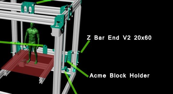

    Can someone help me please. I cant find the STL for the part labelled "Z Bar End V2 20x60 (The outside plate).
    Z_BarEndsV2 for 20x60.stl is the other side:

    I have managed to answer my own question:
    When I open file with the windows viewer I only see the one half (as above).
    If I import the file into sketchup I see both parts:
    I have not encountered this before.

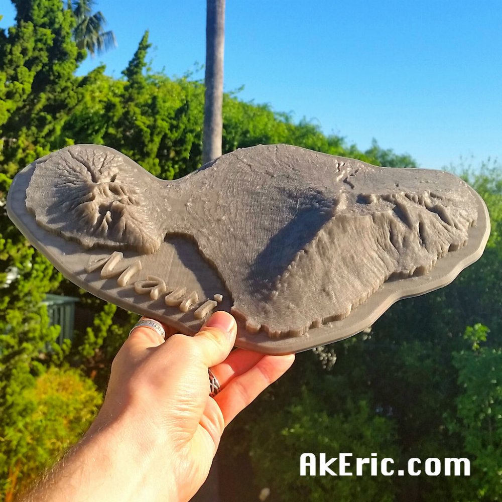

    Some show-and-tell time.
    Just spent a week on Maui: When I came back I felt inspired to make a 3dprint of the island: Above pic is what I came up with. Printed on the diagonal on my 12x12 platform, it's 14" across.
    I had to download a bunch on individual chunks of the island mesh from the terrain2stl web app, then seam them together in Maya, + add the base and text (quite a few hours of work...). Sliced in Simplify3d, 200 micron, .4mm Volcano nozzle at 90mm\sec, 20% infill (probably should have done 10% to help with some of the roof issues), 2 shells, took about 13 hours in Makergeeks Gray'matter Gray PLA.
    I'm pretty happy with it! Next up will be paint.

    Love it, want to print one as well :) Would you be up for sharing the stl? Are you planning on blogging how you made it?

    Once I get the paint finished, I'll blog about the whole process from start to finish. I don't plan to release the stl's for free considering how many man hours it took me getting the whole thing assembled: I've printed & sold my (similar) Oahu project in the past.
    But, I'd be happy to send them your way Carl as a thanks for your great C-bot project ;)
    However, it's not one stl file, it's like... 32: It was so much data for each map chunk, I couldn't get Maya to boolean them together successfully. So it meant a lot of arranging of separate models in Simplify3d, like a puzzle of Maui all made out of little squares :p
