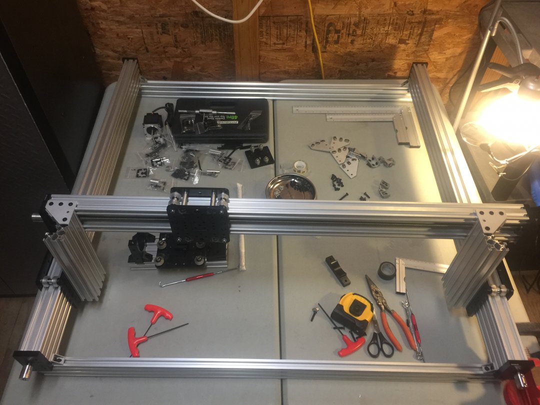

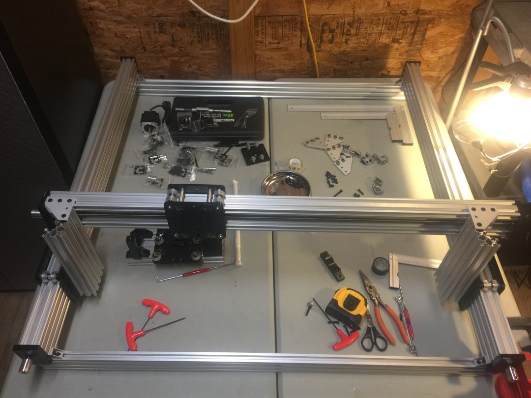

  28. tetsuwan
    tetsuwan New
    May 6, 2015
    Hi guys,
    I'm just about to finish the mechanical bit of my XLarge and as I went along I noticed some things I would like to upgrade, like switching the two 20x60x500 to c-beams for 20mm more Z -height, and build a table from 20x80 v-slot instead of MDF.
    However, my main issue is the deflection on Z/X. This is me pressing on top of the spindle motor,
    I've been thinking about how to stiffen the X C-beam without changing the gantrys, but nothing really makes sense. I saw one build in the gallery that uses double c-beams joined together, but that means you have to extend the screws for the wheels (using threaded rods instead) and that creates new problems like mounting the Z-gantry.
    There is some space on the "inside" of the c-beam to add material, like L-shaped stainless steel or U-shaped aluminum. But the maximum material thickness is about 3mm to clear the acme blocks. Is that really going to make any difference?
    Any ideas out there?
  29. Giarc
    2,934
    1,627
    Could you add 1/4 inch spacers and longer screws to the X axis axles then bolt on a 1/4 aluminum plate the whole length of the X on the side opposite the channel? I did something similar on the Y axis of my build.
  30. Moag
    Moag Veteran
    Mar 16, 2016
    183
    294
    That's the whole idea of the build is to adapt it to your needs:thumbsup:, the hardest part is working out what they are and the real world limitations.;)
    What you're mainly seeing is combination of twist and deflexion of the long Xaxis C-Beam, which is hard get around. The best bang for your buck is simply reducing the span of C-Beam.
    Something that I'm planning to do on my build for that very reason, as its main use will be carving out curved 2.5D aluminium moulds where accuracy and rigidity is what is needed and not work piece size or speed. Still thinking about how I'm going to do it, but I think it is on the cards for my future.
    Have a look back to page 3 of this post to how I added a aluminium U channel to the C-Beam and this discussion of some alternative solutions. If you come up with some others, please share.. ;)
