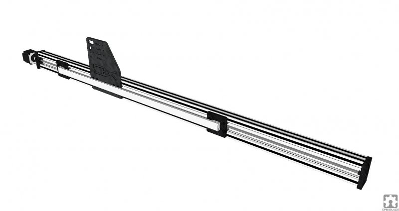

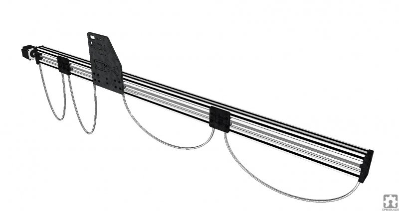

    You'll actually want the supports to slide freely along the screw rather than be tapped and move with it. Here are a couple suggestions:
    Connect the intermediate supports to the carriage with belts or chains such that the carriage drags them into place as it moves away. Granted they will not move uniformly or be uniformly spaced but no matter where the carriage is, the unbraced length of the screw will never be more than half the span as the carriage will pull one to the middle as it moves to one end.

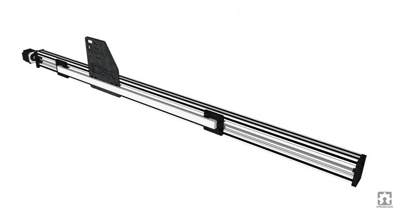

    Alternatively, you could connect the guides with a bar half the length of the rail. As the carriage bumps them, it repositions them to where no matter what, no more than half the span of the screw is unsupported. (Note, the bar is only connected to the guides, the carriage moves freely between them.)

    Yes, just a smooth hole in a guide block. That is all that's required to provide support. If you tap them, they move with screw movement and the screw would force them to the end fairly quickly and lock up the screw.
