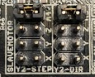

    What are the A3 and A4 jumpers on v2.7 in the motor slave jumper set? upload_2020-4-28_15-49-18.png
  16. Peter Van Der Walt
    14,115
    4,130
    Funi likes this.
