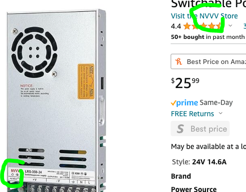

    Been looking at the Meanwell power supplies. I cant justify 18.00 shipping from OPenBuilds put it over 100.00 just for a power supply there other sipping options out there that are not so expensive. So I was looking at the same brad (Meanwell) in the 24Volt and found this. Or if you have any other suggestions on a diffrent power supply thats not so expensive . Amazon carry alot of Meanwell power supplyes
    14,571
    4,230
    They also carry NVVV, Meamwell, Mean_well, WEHO and MW. Be Careful!
    No more counterfeit! MEAN WELL is determined to fight for the trademark and intellectual property -MEAN WELL Switching Power Supply Manufacturer
    There are lots of cheap counterfeits! Fight that - by going through authorised distributors like Digikey, RS, Mouser, etc if you can't get it from us.
    Your's logo doesn't look like the Meanwell logo at all! NVVV might look like MW if you throw no care into looking, but I can promise you the dirty power that thing will kick out will screw up the Blackbox!
    versus
    Saving that $18 will cost you a $239 BlackBox not being covered under warranty. We do take note of purchase history if damage seems to be PSU related. Oh and believe me we see the fair share of cheap PSU damages! Piles of them.
    The official Meanwell LRS350 is still the one we'd recommend, but PLEASE! purchase legit man!
    We've stuck tens of other PSUs on the bench here, oscilloscoping them out under load - and we cannot find any we are as happy with as that particular Meanwell. Built in EMI filtering on the mains side, lightning fast overcurrent shutdown, no ripple, no overshoot on startup or overload or extended load. Its just filled to the brim with filtering components that the cheapies think you can "do without" - fine for running a couple LED strips. Not fine for running an expensive controller.
    Or, you'll have to accept that becomes an even more unlikely possibility. It needs good clean power. It needs a PSU that is EMI compliant (properly tested, not bribed certificates or no certification at all just printed logos counterfeit style).
