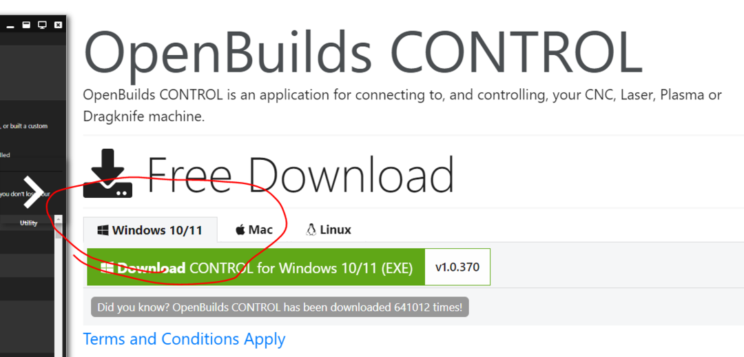

  7. Giarc
    2,934
    1,627
    Windows 7 may be your problem. Prior to OpenBuilds Control, what control software did you use? A couple of years back, I used it with an old Windows 7 tablet, but it was not ideal. I have moved on from attempting it with Windows 7.
  8. jltcet
    jltcet Well-Known
    Oct 24, 2023
    100
    15
    Unfortunately my computer won’t update from windows 7 it’s worked fine up until now. I’m gonna try a different file tomorrow see if just by chance it’s corrupt some how. Planning buying the Open Builds Controller this next year after I get the Black Box paid off

  21. Peter Van Der Walt
    14,104
    4,127
    Well, I am in the southern hemisphere, and the days are getting colder. Took out an extra blanket last night.
    If we apply the same to where you are, it must be getting warmer after 4 months of winter. docs:blackbox-x32:currentadjustment [OpenBuilds Documentation] might come into play, overheating now that ambient temps are higher? Check for the presence of the FAULT LED when it loses position
    Interface won't solve the issues (not PC related, at least not likely)
    But do note Win7 is no longer supported for CONTROL. 10 or 11 only.
    PS :) Same contact, different contact method. I was referring to the Fault LEDs mentioned in second half of docs:blackbox-x32:currentadjustment [OpenBuilds Documentation]
    Work through the PRODUCT TOUR at docs:blackbox-x32:layout [OpenBuilds Documentation] - the LEDs are at section 1(g)
