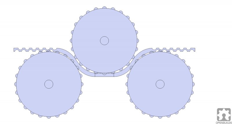

  10. The Dude
    The Dude Well-Known
    Jan 2, 2014
    243
    102
    Here's another way to do it
  11. Mark Carew
    2,750
    2,423
    How about using that same system with a two sided belt
  12. The Dude
    The Dude Well-Known
    Jan 2, 2014
    243
    102
    yeah that might work. I was also thinking of maybe a a tank tread. I think the 2 belt solution has pros and cons. By just having 1 belt glued down you could get a really precise rack. The solution with 2 gears and 1 motor sprocket seems logical. I think you would have some mechanical wear. That being said, If you wanted to get a stronger system it would be just as easy to glue down a bicycle chain and use a sprocket off the bike as a metal rack and pinion capable of ungodly torque, lol.

  16. The Dude
    The Dude Well-Known
    Jan 2, 2014
    243
    102

  18. The Dude
    The Dude Well-Known
    Jan 2, 2014
    243
    102
    You could assemble the carriage and then use it to press the belt down while gluing. Just roll it back and forth a few times every couple minutes until it sets. Anyway this would eliminate belt stretch with higher torque. As for slippage I dunno. Maybe a bulldozer wheel track would solve that but now you have a belt spinning.
    What if you do 2 wheels like in my drawing and add another toothed wheel to the motor... so there's always 2 points of contact on the motor gears and on the belt?
