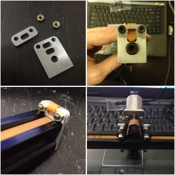

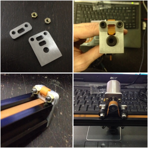

    This really works great!!! :D:D:D... but my belt is disintegrating like crazy! :(This is just speculation but I believe that the belt is either being pinched or rubbed against the extrusion which is causing considerable wear. Have done any long term tests yet? I've been running mine almost non stop at 20-30mm/min for about 2 or 3 days now and I've noticed marks on my belts with little bits of rubber below the extrusion.
    http://imgur.com/a/DGR5u (the photos are too large to upload in thread sorry)
    Abraham likes this.
  11. Mark Carew
    2,750
    2,423
    I had this happening as well at first and I think its from the belt rubbing against the track as it comes out. After a while it stopped and seems to have broken in with no issues in performance.
    To stop this from happening I think that a urethane belt may be in order and that is going to be tested.

  17. Robert Hummel
    Robert Hummel Custom Builder
    Moderator
    Nov 14, 2013
    978
    715
    After looking at your pics I see that the belt is raised out of the V-slot.
    If I'm right your problem lies with how your belts are fastened.
    By having them raised out of the extrusion it allows for pinching of the belt.
    Just my 2 cents try something like I did and I have 0 issues
    Hope that helps

    As of right now, I am not 100% satisfied with this sort of setup. I still have issues with the belt ripping and I have a higher degree of inaccuracy than I did with my previous setup (gear pulley, cart, idler pulley) I find that I can be anywhere from .5mm off to .9mm off and it's in consistent. Though this is within the tolerance that I expected for my printer at this time, because it's a work in progress. Either way, this still saddens me.
    Now that being said, here is a brief synopsis of the observations that I've made since making this setup. Since my initial install, I've "upgraded" to 10mm wide GT2 belts with a ~11mm Dia metal gear pulley and the 'ripping' continues. Robert Hummel suggested that I lower the attachment point of my belt to where it lies within the extrusion in order to stop the rubbing against the extrusion. I have not had the time/money to do this yet but I do not believe that is the problem anymore.
    I believe the problem is due to the wheels actually. From what I can tell, the majority of my issue resides in the mismatch of the diameter of the wheels and the diameter of the pulley. The pulley is about 11 mm and the wheels are about 24mm. I haven't done the math on it yet but I'm pretty sure that if I either
    A.) enlarge my pulley.
    or
    B.) Use an alternate setup in which I have 2 idler pulleys instead of the wheels for the R&P setup.
    Once I do the math on this I'll get back to you but overall, I do not recommend this unless it's a temporary setup. Also, Openbuilds now sells solid wheels (without the valley in the middle) I would recommend those for this. I believe they could also help with this issue but again this is just speculation.
