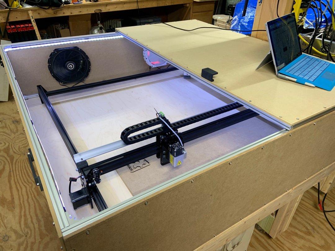

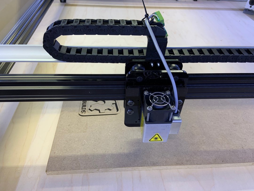

    I have pretty much finished up my ACRO build with an enclosure. This is an ACRO 1010 kit. Added a couple of drag chains in place of the tubing for wire management. Sitting on a table with casters so it can be moved around the workshop.
    Using an Opt Laser PLH3D-6W laser.

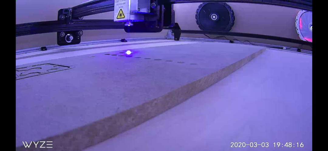

    Enclosed the build for added visual safety and smoke/fume handling. The enclosure frame was built out of 1515 extrusion. Currently "skinned" with 6mm MDF. I wanted to use 6mm black HDPE but waiting until a new store opens up down the road that carries sheets at reasonable prices. (Will replace the MDF once I get the HDPE). Two full doors at the top allow access to the full work area. These use a hinge I printed which allow the doors to be removed completely without any tools. LED light strip inside around the inside of the enclosure. Two large fairly high volume fans provide smoke and fume extraction via flexible ducts to outside. Added a Wyze camera inside the enclosure for watching progress from my phone. Plan to add a couple of viewing ports with laser safe windows when I can find some at a decent price. All of the electronics are mounted to the table, outside of the enclosure.

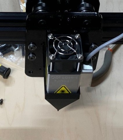

    Created a little "snap-on" cover on the laser which comes to a point at the optimum focal point for the laser, allowing me to easily align to my starting point (including z height), then pull the cover off.

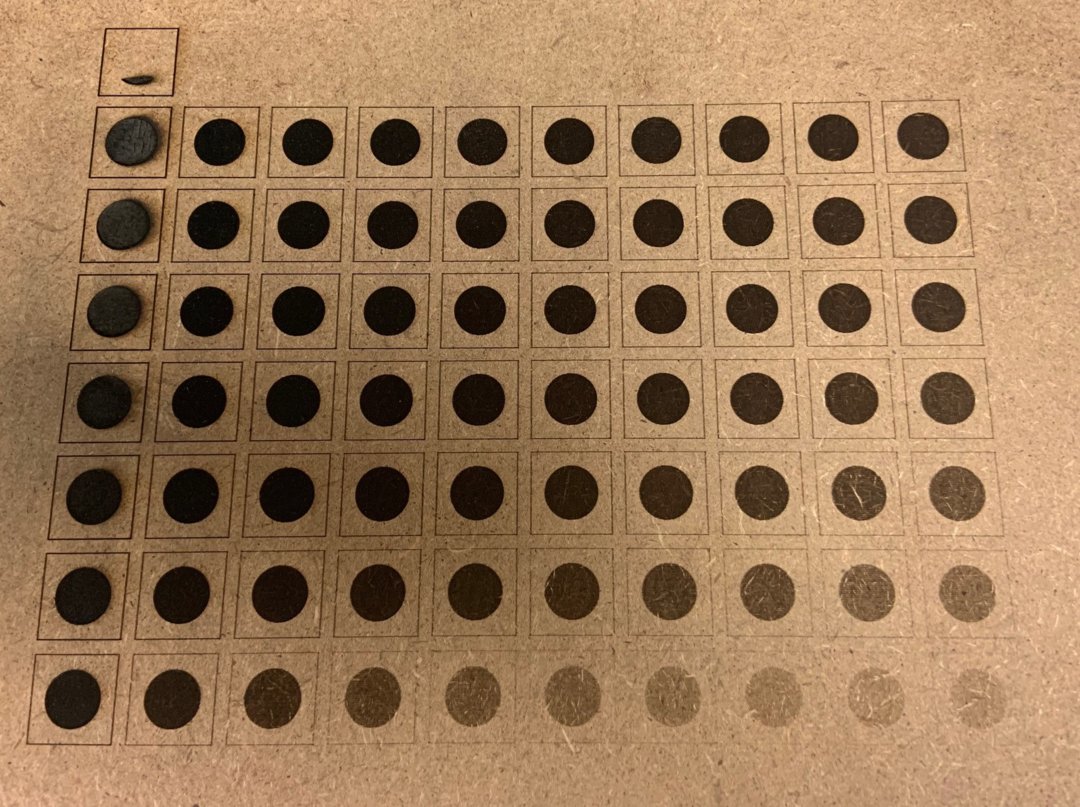

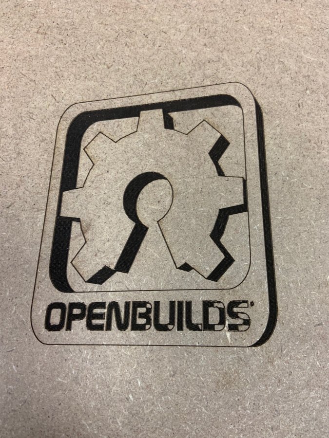

    Also played around with a little test pattern I made up, experiment with different power levels and feed speeds.
    Having a lot of fun playing with this thing!

    Curious what you used to attach the aluminum angle to the corner plates? Have some drag chains from another project that would be perfect for this on my Acro.
  5. romamaker
    romamaker Well-Known
    Nov 14, 2017
    69
    54
    Thanks for reaching out. So, there are a few printed parts involved here. If you take a look a look at the picture below, the grey piece is one of the plates that comes with the ACRO kit. One of the "Y" plates that houses the Y motors. The green piece shown in mounted at the top. One on each side (mirrored), attached to the plate via a small bolt and nut. (Probably an M3, but can't recall off the top of my head.) I drilled a small hole in the bottom of each end of the aluminum angle, and that mounts to hole in the top of the green piece. (The hole in the printed part was purposely elongated to allow for some minor adjustments to the placement of the aluminum angle. The yellow piece shown in the image is also 3D printed. It's an attachment point a drag chain for the Y axis. (That chain just rests on the table.) I can take a better picture for you when I get home later, if you would like.
