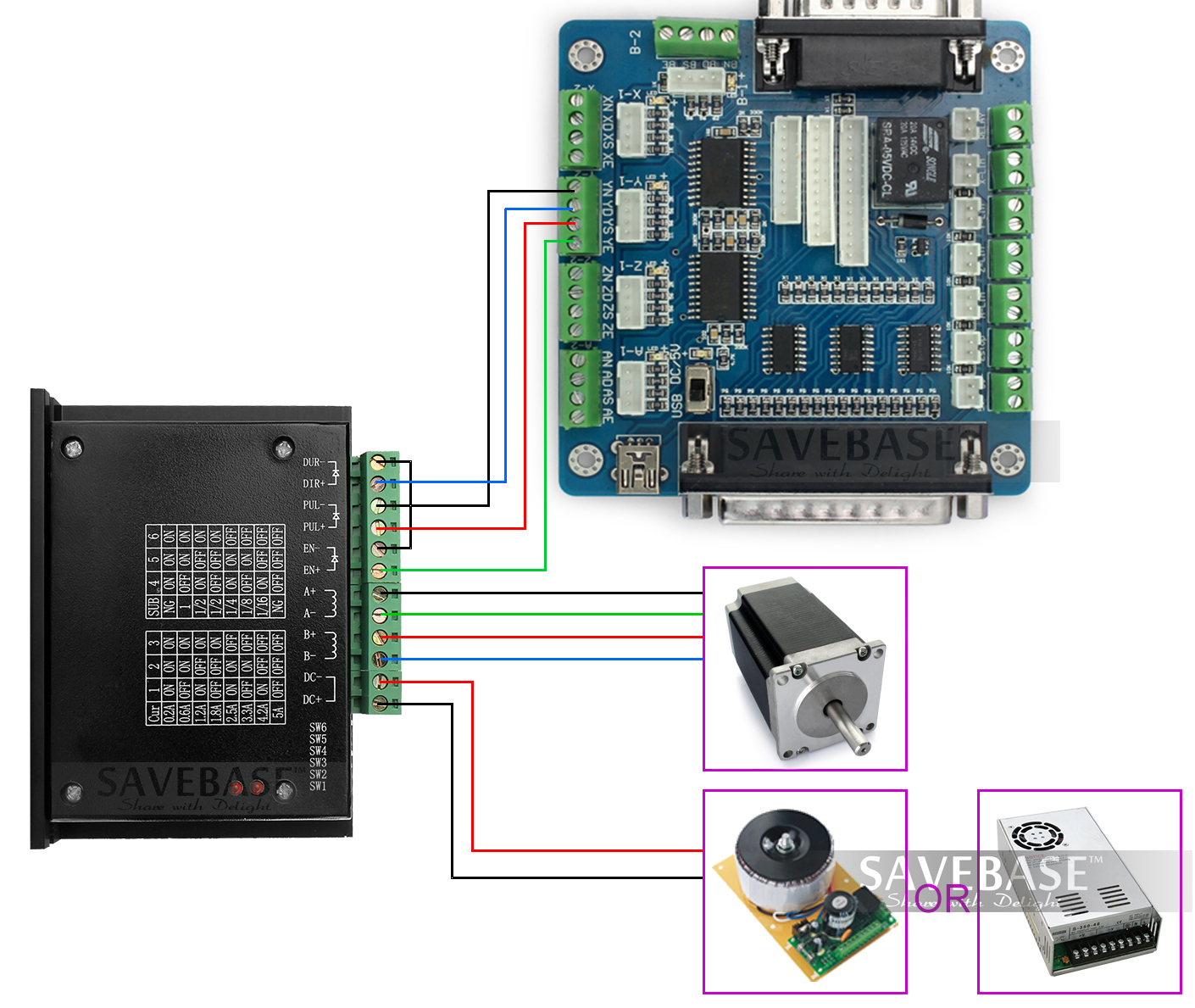

    Now the problem is I don't know how to wire the stepper motors up to the board as there wasn't a diagram sheet with it. I've since found a graphic of the wiring but it doesn't line up with the 4 wires on the motors. If anyone else has used the same board and got it to work could you tell me how you wired it up. I attatched a photo of the board to this mail.

    Are you trying to wire the motors directly to the board? You need motor driver modules between the board and the motors as shown in Larry's graphic.

    Mark is using an entirely different type of controller. Mark is using a Seeeduino/gShield combination where the gShield portion of the assembly contains the motor drivers. The part you have is called a break-out board (BOB) and all it really does it provide an interface between the computer and the driver modules. You will either need to get an all-in-one board or add driver modules to the one you have. In the OX build that Robert Hummel is doing, he is using a similar break-out board and he included a photo of his driver array.

    So I have to get 4 of those 'Driver Modules' from eBay to sit in between the Breakout Board and the Stepper motors.
    Its just that after seeing Larry's board above I went and bought that, one as the wiring is much more straight forward than the one I've got already. Do you think those 'Driver Modules' That Robert had will be OK attached to this board.

    These are the drivers I'm using and I'm happy so far, grounding must be done properly or you will have jittery movement and skipped steps
    Also don't push them past 30vdc
    http://pages.ebay.com/link/?nav=item.view&alt=web&id=251768835869

    This picture shows how things get wired, on your drivers I believe the step is marked CP not PUL
    Once wired you must setup Mach3 to control the pins correct
