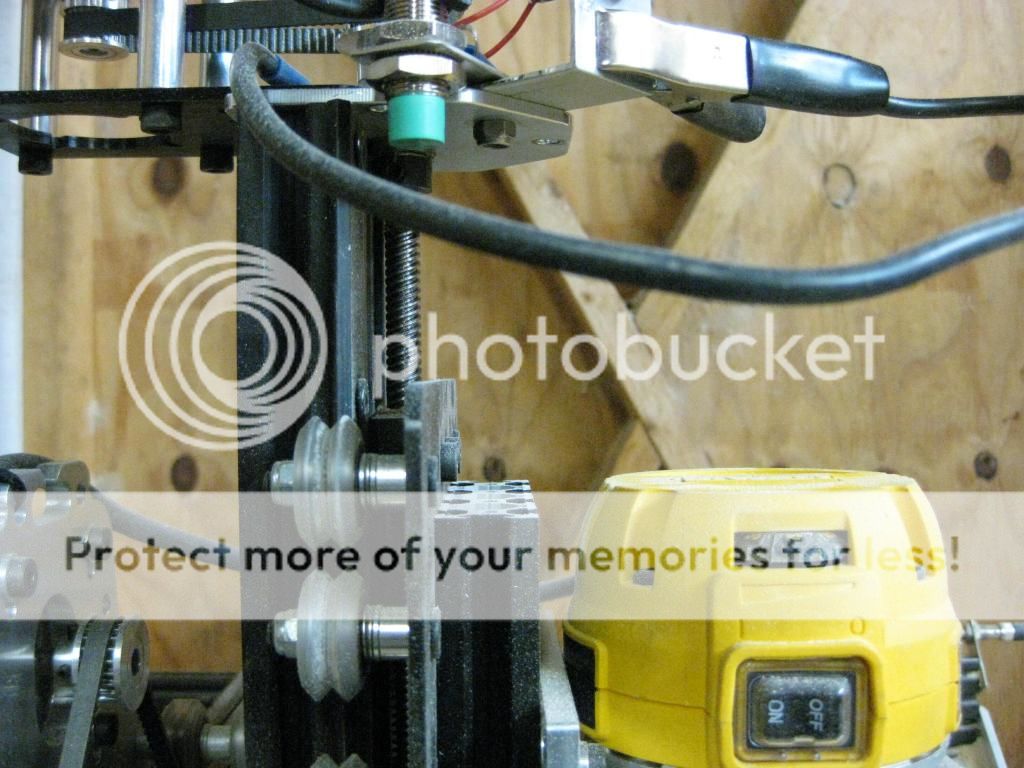

    Is it possible to take out the 20 x 80 between your router mount and the large openbuild plate completely or am I missing something?
  27. Hytech2k
    Hytech2k Veteran
    May 6, 2014
    429
    331
    The mount I purchased from Chris is setup to mount to 2060 and apparently that plate isn't... I could only get 2 holes on one side or the other to line up... But it has holes for 2080 so I ordered a new router mount back plate from Chris with 2080 spaced holes and bolted that extrusion there to give me some more clearance for my dust shoe and router.
    Plus I like the flexibility of being able to adjust the mount up or down by loosening 4 bolts on the front of the mount rather then disassembling the z carriage to get and bolts between the x beam and front plate.
    Sorry about the blurry photos had to take them while it was running..... :)
