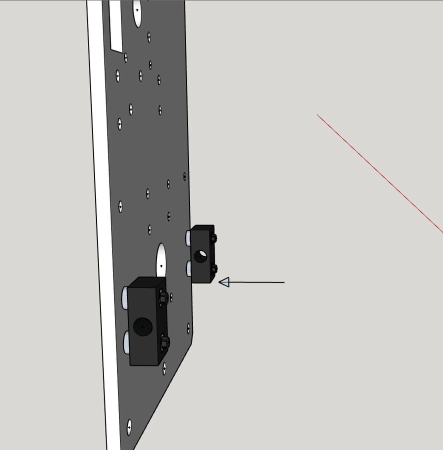

  7. CTHansen
    CTHansen New
    Sep 23, 2020
    A little follow-up.
    Disassembled the right side of the gantry and checked things out. Wheels seemed sluggish, so removed them and cleaned and lubed them with silicone. Removing the gantry plates, they seemed a little bit tight as well, as if the spacers didn't have quite enough of a span to begin with. I didn't remember noticing this when putting the machine together. Putting it back together, I was conscious of this and made sure not to overtighten anything. The nylock nuts seem to do a good job, so I'm not too worried about it.
    Also, the nut blocks seemed to have some odd wear a little bit of plastic fuzz on the outside of the holes that I was able to just brush away. I loosened the screws that held the nut blocks to the plates and didn't tighten them until I got the cart back in place with the lead screw threaded, again making sure not to overtighten.
    Then I ran across this on RE: the quenbe upgrade: "The original design spaced the nut blocks using the bolt and standard metric spacers. While this worked, the nut blocks were very easy to misalign and adverse movement of the nut blocks resulted in the feed rate being limited. The quenbe PRO overcomes this issue by securing the nut blocks in place using a specialised spacer block. With our new specialised secure spacer block there is no unwanted movement in the nut blocks due to the extended standoff."
    So brrian, looks like you were correct about the nut blocks.
    Things seem to be moving better when jogging, so I'm going to try running some stuff with reduced feedrates and see how it goes, but I think I am going to go the quenbe upgrade route.
    Thanks to those that responded.
    CTH
