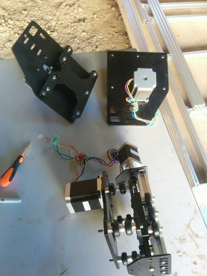

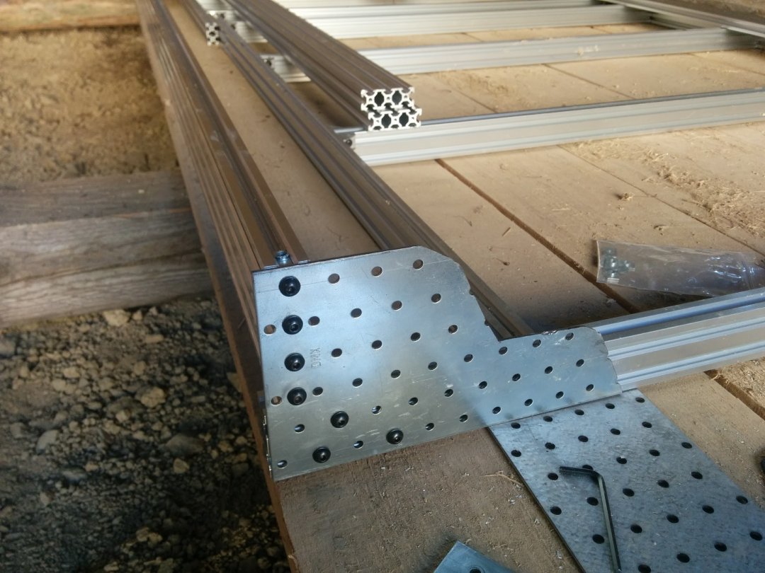

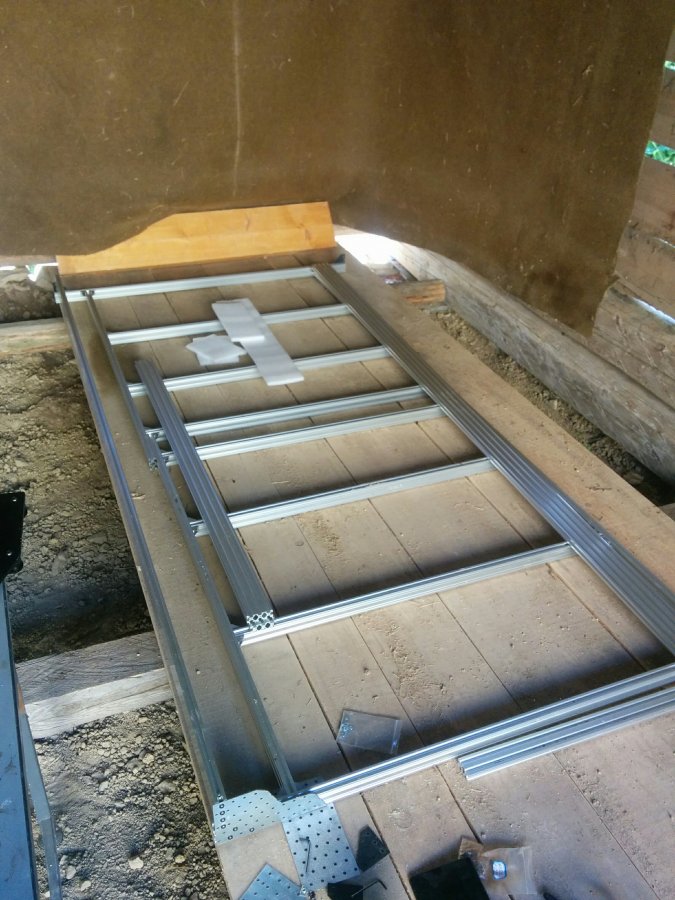

    Hey all, I'm back at work and starting to build the machine - now I am starting to hit issues and fixes, but looks like I may have royally f****ed up on the electronics - frustratingly...
    Few notes...
    • Not all the M5 screws I purchased were low profile, I have been lucky and swapped a few around where needed. Save yourself the stress and be sure to get all low profile
    • Way underestimated the number of Tee Nuts (50), with the table support I need more in the region of 200
    • Like a tool I cut the V-Slot 20x40mm X Axis Back Brace by mistake, new one is on order
    • The "5 Hole 90 Degree Joining Plate" for each corner did not appear to be up to the job, so I made my own out of a few metal plates
    • Trying to find a tapping drill bit was impossible, so all V-Slots ends where manually tapped if needed
    Now, for the electronics, this is what I have purchased...
    The issue was discovered when reading up on how to configure the Current Limit on the DRV8825, they are limited to 2.2 A - my NEMA23 are 3A. I have read that it is fine to provide a lower current to the motors, but also read that it may mean they will not run at all. So, the best thing to do is a test, but, I have not ordered a PSU for the motors.... this order was made last year so I can only guess that I was planning on using the Spindle 48V PSU, but, the RPI CNC Board is limited to 12-30VDC. Buy a 24V PSU..? But, is that now a waste of time and money as my NEMA23 require 3A?
    So, as you can see I have gotten myself into a bit of a pickle. Before I make a purchase in anger, I would like to get feedback on the following questions...
    • Am I correct in thinking that I should give up with the DRV8825 and order 3 * DQ542MA?
    • As the DQ542MA are External Drivers (RPI CNC Board can support this), do I need a PSU for each one or can I run all 3 from one PSU?
    • Any suggestions on a reliable EU source for these parts? I have made an V-Slot order with OpenBuilds Poland but they are ignoring my messages for an order update and looks like ill have to ask PayPal for a refund
    Thanks in advance for any advice, it appears I have fallen into the common noob electronics mess. Also, apologies to @JustinTime who clearly said "276 oz/i and about 2A" - I clearly missed the 2A part of that :(
    A few pics of my progress to date...
