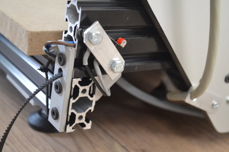

    Little update;
    I moved the Y axis limit switches from the fixed table to the movable gantry. This way i have one bunch of cables, eliminating teh need for a splitting limit switch cable. DSC_0001 (3).JPG
    Added a lillte alu profile to protect the switches during moving of the machine;

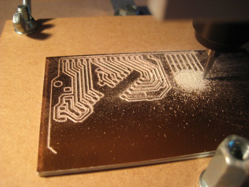

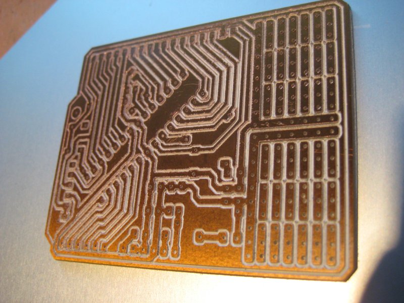

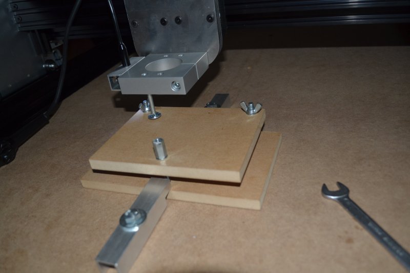

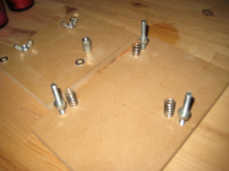

    Today i have made my first PCB.. ever! :)
    A level bed is very important for milling PCB tracks, because you don't want to cut too deep.
    I have made a little adjustable bed especially for milling PCB's.
    Construction is dead simple; two pieces of MDF with 3 holes in them. (oversized holes in upper one allows pitching) In the bottom one 3 bolts are mounted (fixed). on the lower plane 3 little springs are attached (in this case holded snuggly into 3 under sized holes).
    3 bolts go on the bolts, upper plane, and again 3 bolts.
    This ables you to lower the Z-axis at 3 points (near the 3 bolts) 3 times at the same height, compressing the spring a little bit. The only thing you have to do is tighten the lower bolt and then the upper bolt.
    I used an "dome head" bolt screwed into a M6 hole in my kress mounting block, lowered my Z-axis only once and moved it around. The bed follows :)
    This really is my first try in milling a PCB, and the results are above satisfying i must say. When looking up close, it's still a little bit rough and the depth of the tracks seems not the same everywhere.
    (Note: When you're cutting not deep enough it's is simple to adjust the bed in one corner a little bit and run the program again, in this case that was not neccesary)
    I used a 0.2mm 30 degree carbide bit for all three stages (layout, holes, outside) because i'm still waiting for some other small bits to arrive by mail (just testing now really) Spindle speed about 20,000 rpm, feed rate 500 mm/min
    I set the depth of cut to 0.2mm for the tracks, 0,4mm for drilling (i know, not really a suitable bit for drilling ;-)) and went 1.4mm deep for the outside making the edged peel off easilly.
