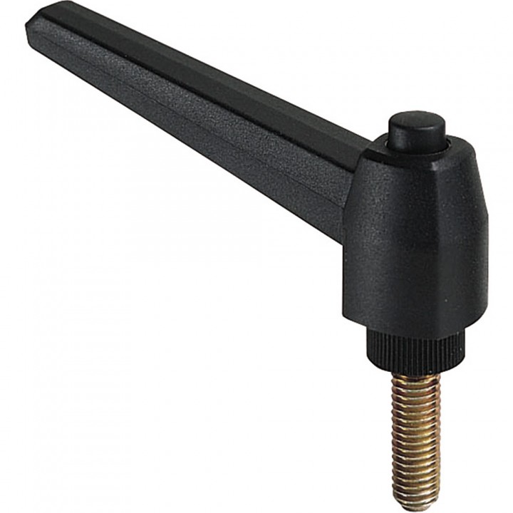

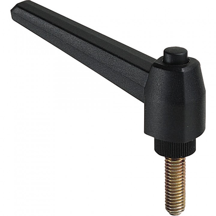

    I've done furniture like this with Bosch Extrusions but for sure V-Slot looks better! Great build you got there, I'll translate it and put it up on the Mexican Website. I'm learning how to use SketchUp and will drop some designs as well soon.
    How about an quick adjustable table? You can use 4 End Caps (V-Slot) as mechanical endstops, 2 on each side, one at a sitting height and the other for standing. Using knobs like on the picture below would work with a 7 Hole Cross Joining Plate. Also, an electronically adjustable table must be possible with 2 ACMEs (pricey I know).
    Also, floors are not always 100% flat, the same knobs can be used to adjust the table, think about that ;).

    We were looking to use these on the L brackets so that we could adjust them but just did not get this far :) Your right though I just had to re-adjust it today as Trish (My Wife) was not happy with the height so these would com in handy. BTW spam pic replaced for a clean version ;)
    They also have handle version of these knobs as well that are pretty cool and would work great

    Sorry about the spam picture and next time I'll put up a clean one directly. The handle version is okay if you have enough space for it to turn it 360º, but I don't think you have the space for it unless you make longer plates (just thinking out-loud here, I might be wrong). You might indeed leave the wood off and place the handle then. 3D printing a knob and glue it on a M5 could be the real opensource version (when shared) :).

    LOL I didn't even think of this. Maybe we could use the knob ones but only use one per side in the center. That way it would be quick adjust when needed. It should have more then enough holding power. We could also leave the screws in place on the out side to really set it in place if need be. Just a thought

    I know that the 80/20 version of those handles are spring loaded and have detents. That way if it is in a tight corner, they can be pressed in and turned without turning the screw. Also the can be pointed away from the user once everything is tight.

    I see, so that might be a release-button on top but it's hard to see on that picture if it's spring loaded.
