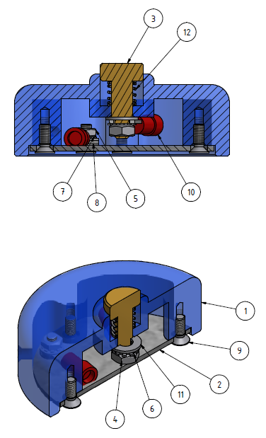

    @Tweakie In the your main article you mention:
    Any chance you could upload a picture or some more information?
    I'm looking to add a fixed tool setter system to my new build like the below picture though first want to see what else you use ;)
  22. Tweakie
    Tweakie OpenBuilds Team
    Jan 18, 2014
    786
    294
    Time marches on, no sooner had I completed most of the documentation for the construction of my low profile tool setter, I was approached (totally out of the blue) by a commercial concern who were interested in buying the design. The negotiations took some time but I finally sold the design outright so I am no longer able to disclose any details of this item. Sorry.
    Tweakie.
  23. Indieflow
    Indieflow Veteran
    Mar 28, 2014
    116
    75
    Not a problem at all, the picture tells me everything I needed to know ;)
