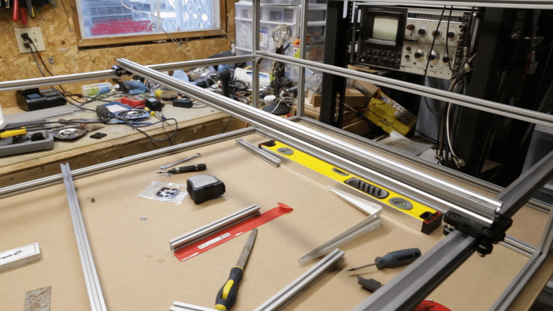

    This is my first attempt at designing using v-slot or t-slot, so any feedback on my design would be appreciated. In my head it seems like it should be sturdy, and functional for a frame?

  7. silverchris
    Mar 12, 2018
    Some progress has been made, though I am having some issues.
    I managed to get the frame assembled, though I am having a little bit of an issue with the X gantry having what feels like a lot of wobble/wiggle in it. E.G. when I grab one side of it, I can pull it back a little bit, or pull it forward before the other side starts to move.
    I have a feeling that it comes from my frame not being perfectly straight, so this week, I think I am going to pull it apart, and check the squareness of the cuts on the ends of the t slot/v slot, and double check the lengths are all the same.
    Also, this photo clearly shows that I need more shop space :)

  12. silverchris
    Mar 12, 2018
    I should have taken a video of the the wobble, but I think it's a bit excessive to be the flexibility of the 20x20, it might be a few centimeters each way, and the 20x20 doesn't feel like it would flex that much in the hand. I think the mini-v wheels aren't being allowed to sit flat in the v slot, letting them have a lot more side to side play in the v slot than they should? I will have to do some playing tomorrow, as I didn't really check if the amount of play changed when I rolled it along to a different part.

  14. JustinTime
    JustinTime Veteran
    Dec 18, 2013
    759
    253
    I think that before you start pulling it apart try screwing the frame to the table and installing some plates on the corners. You'll need about 20 of them and they will stiffen up the frame immensely.
  15. silverchris
    Mar 12, 2018
    I ended up taking it apart, and probably should have done this before I started... I checked the lengths of the pieces, and it seemed they varied a few millimeters from the company the cut the t slot, as well as the ends not being very square at all.
    Having a local machine shop mill them straight, which will affect my finished size a bit, but at least it will be square
  16. silverchris
    Mar 12, 2018
    Still seems like I have excessive slop in the movement?
    Actually remembered to record a video of it. The rest of the frame doesn't seem to flex at all during this, so I am not sure if its flex in the piece I have going across, or play in the mini-v plates?

  18. BNMaker
    BNMaker Well-Known
    Jul 13, 2017
    62
    38
    My initial reaction from looking at your carriage is that there isn't enough of it to not wobble. The mini v-wheel gantry just isn't wide enough to overcome torque inertia and your delrin wheels are compressing and unloading. in effect giving you some unwanted suspension.
    I've always viewed the mini v-wheel gantry as being used for carrying something light, but you've got about 600-700gm of torque on a long lever arm without any damping and you are moving it from one end only - it's doing what its going to do.
    But... that won't happen with belts in place.
    I have a 1500mm run of 2060 Y-axis with a cantilevered 600mm 2020 X-axis carrying a mini-v gantry and 200gm of laser diode. It doesn't bounce or vibrate at all. When it was only a 2040 Y-axis, I used to get oscillation under stop/start. The wider stance I got by making the y-axis plates bigger to accommodate the 2060 and wider to give it more rigidity and a third pair of wheels means theres no slop or wobble.

  19. NthAxisWorkshop
    Apr 11, 2018
    55
    24
    Howdy. This is a great idea. Do you have your source yet? Are you going to use a DC or metal tube? Gonna be cool to see it go. On your X slop...the engineer above is right. You can get rid of some of that slop by changing X gantry mini v-wheel plates. Double their length along X and add a couple more wheels. This will spread the load more effectively and reduce the compression of the wheels. You could also try to replace the X gantry 20x20s with 20x40s with the longer axis aligned with the Y. You'd still have to replace the X gantry slide plates. Good luck.
