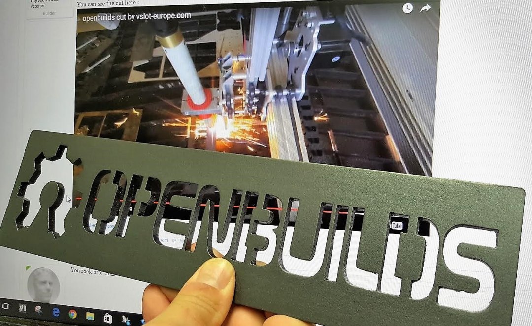

  9. mytechno3d
    mytechno3d Master
    Dec 15, 2013
    64
    161
    Hello Mark , your Openbuilds sign is ready :) , i will paint it and send it to you .
    You can see the cut here :
    gwandad, eddiejr and Mark Carew like this.
  10. Mark Carew
    1,902
    1,040
    You rock bro! This is so cool to watch cut. Thank you :thumbsup:

  27. Mark Carew
    1,902
    1,040
    Props go out to @mytechno3d for sending us this super awesome plasma cut OpenBuilds Logo!
    This is going on the shelf of first :thumbsup:
    Thank you!
  28. mytechno3d
    mytechno3d Master
    Dec 15, 2013
    64
    161
    Than you mark for this nice picture . :thumbsup:
