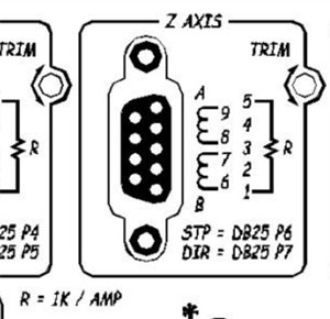

    Currently I am trying to figure out how to connect all the right wires from my steppers to the DB9 connecters. I found this video which was super helpful:
    BUT the Wetlands guy doesn't include a resistor on his DB9 connections as shown in the this picture. [​IMG]
    I know I need to also figure out what resistors I need specific to the ratings of my steppers but I have yet to figure that part out.
