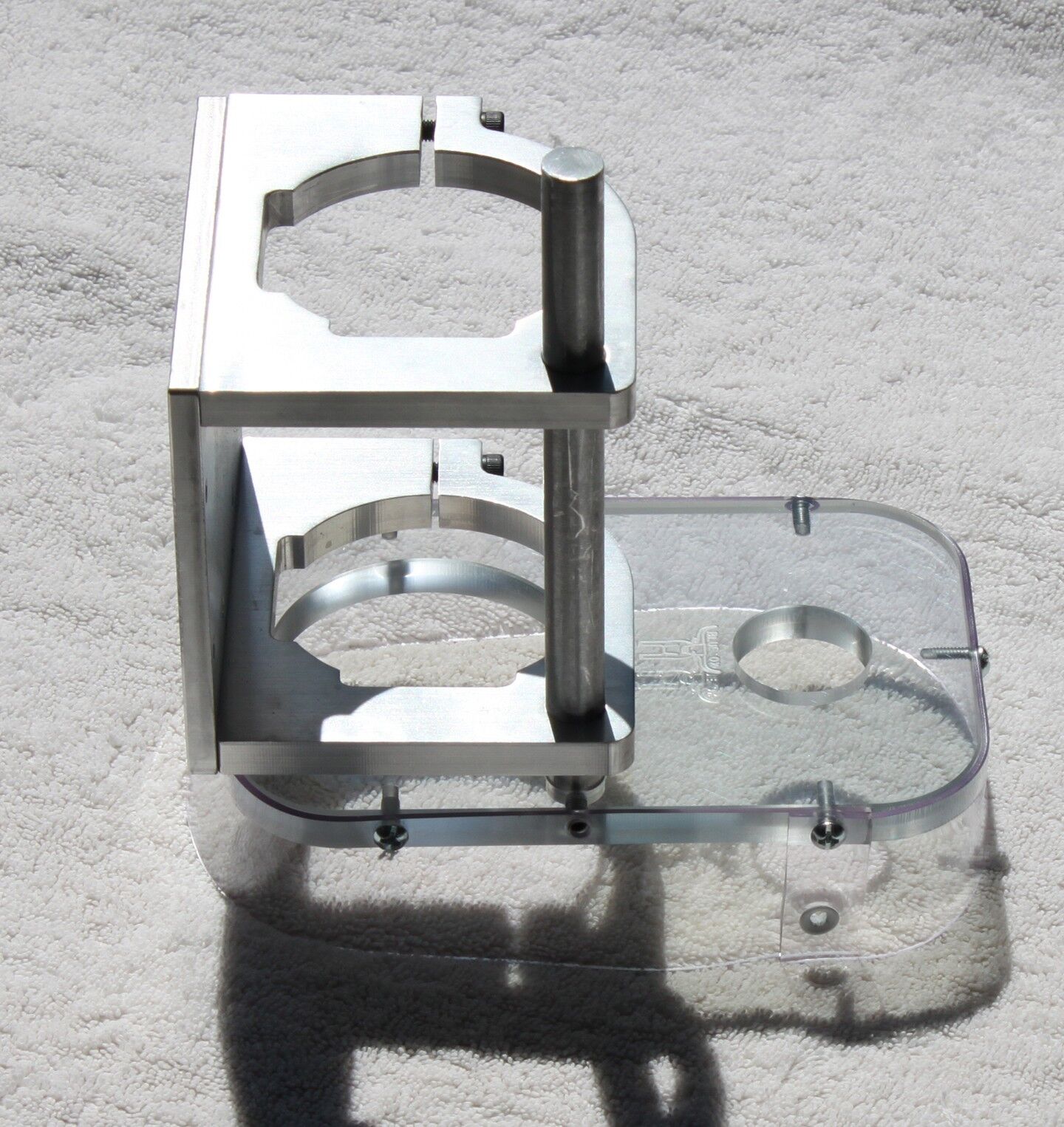

    The Makita trim router pictured is just setting in the too large mount I ordered from OpenBuilds. Anyone have a source for a couple of the spacers used for a 65mm router body with this mount? Shipping to zip code 53590 if possible. I qualify my next statement by mentioning I have better than 25 yrs. experience as a carpenter! That Makita trim router is so quiet just running in my hand.... that I think it may be broken? I will duct tape it to the Z if thats what it takes to cut something soon! Then there will be more questions. :)

    If you look under my Sea-Ox design there is a part called Sea-Ox Spindle Plate. It mounts to 20x80 or 40x80 C-Beam. It converts to attach a 65mm mount like the one I am using. But I am attaching file for you.

    Yes, that is the spindle mount adapter I was looking for. I just don't have any friends cool enough to own 3D printers. Truth be told, I probably do.... I should get out more! Thank you for the heads up. :)
    @Steven Bloom
    Thank you for pointing out the spindle plate. I had previously read your Sea-Ox blog with great interest, and had bookmarked your generous source of custom plates. Your design focus, maximizing the Z-axis travel, is of particular interest. I will look forward to your updates.
