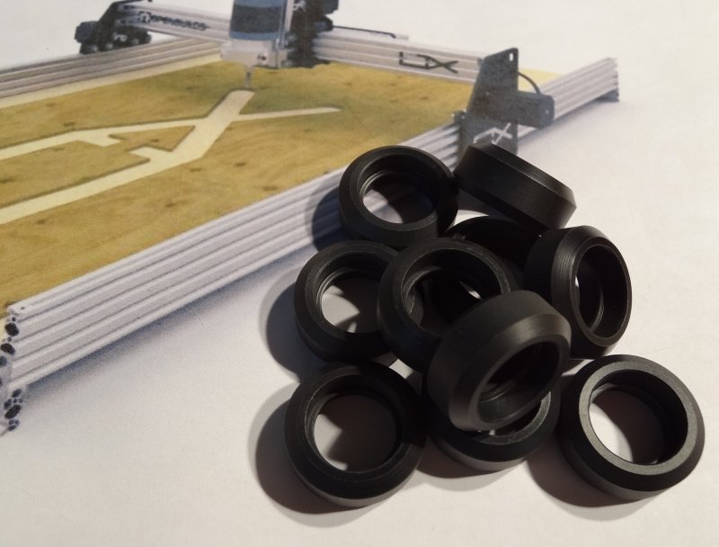

    Almost there guys wrapping up the video for the mechanical part of the build-along as well as finishing up a new strong solid V wheel design we want to have available for this build as well as future builds of this style.
    These wheels should be avaiable from the OpenBuilds Part Store in the next couple of days.

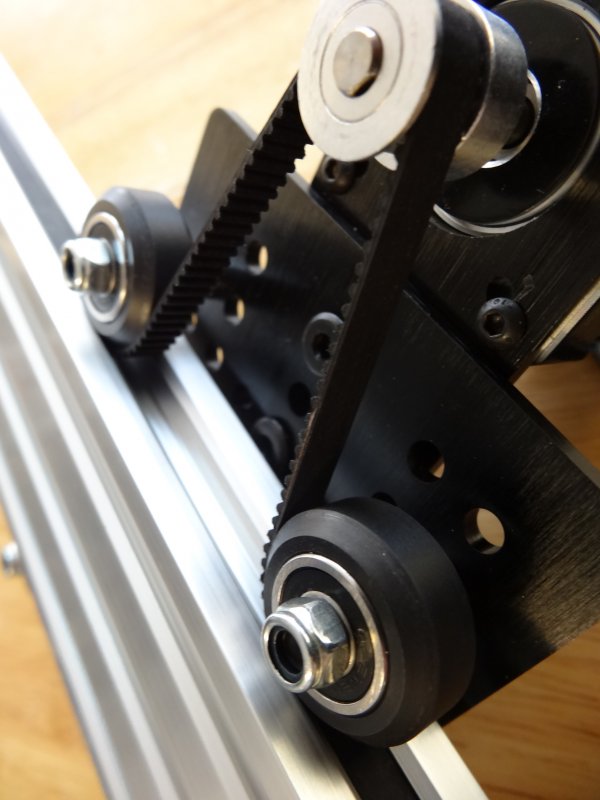

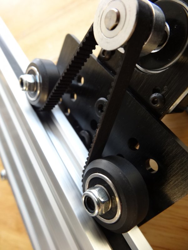

    Those solid v-wheels are exactly what I thought you should be using with the belt drive system you guys came up with. These wheels will be much easier on the belt as it comes up out of the slot in the extrusion. But it would also not suprise me to find that those wheels are more durable then the double v-wheels. They won't have a force trying to pinch the double v together.
  30. Mark Carew
    2,746
    2,413
    Agreed @Nick Lancaster I also think there will be many yet unseen uses for these as we all work toward new builds.
    BTW they have been added to the OpenBuilds Part Store (OpenBuilds Solid V Wheel Kit) in kit form we will add the wheels as well soon.
