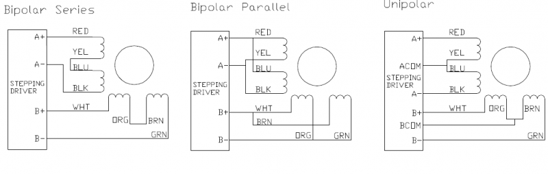

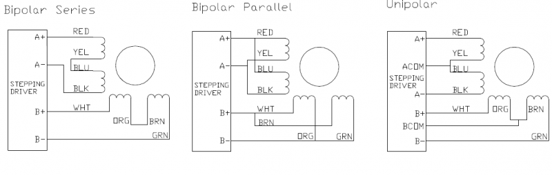

    I have just had a thought I may be wiring the motors up incorrectly.
    I have mine wired as bipolar parallel. should they be bipolar series?
    any body help out there please.
    bob

    I would suggest parallel but both should work, what drivers are you using? Sorry if you already stated

    I would first change up to 1/16 due to the fact you have the power in your motors in turn you should see smoother operation.
    Second running the motors in series increases winding resistance lowering the motors current rating.
    Run them parallel for taking advantage of their full specs

    @Robert Hummel
    "I would first change up to 1/16 due to the fact you have the power in your motors in turn you should see smoother operation.
    Run them parallel for taking advantage of their full specs"
    robert
    Did that and it made no difference.
    So I had a cup of coffee and a think.
    Why did the Z axis work OK and not the others?
    So I stripped down the contol box and put the z driver onto the x axis hey presto it worked.
    I then had a closer look at the driver for the x and y.
    :banghead::banghead::banghead: the clever chinese used "0" for on and "1" for on for the dip switches. So I was running the motors at .9 of an AMP.
    My fault I should read the instructions first.
    Bob
