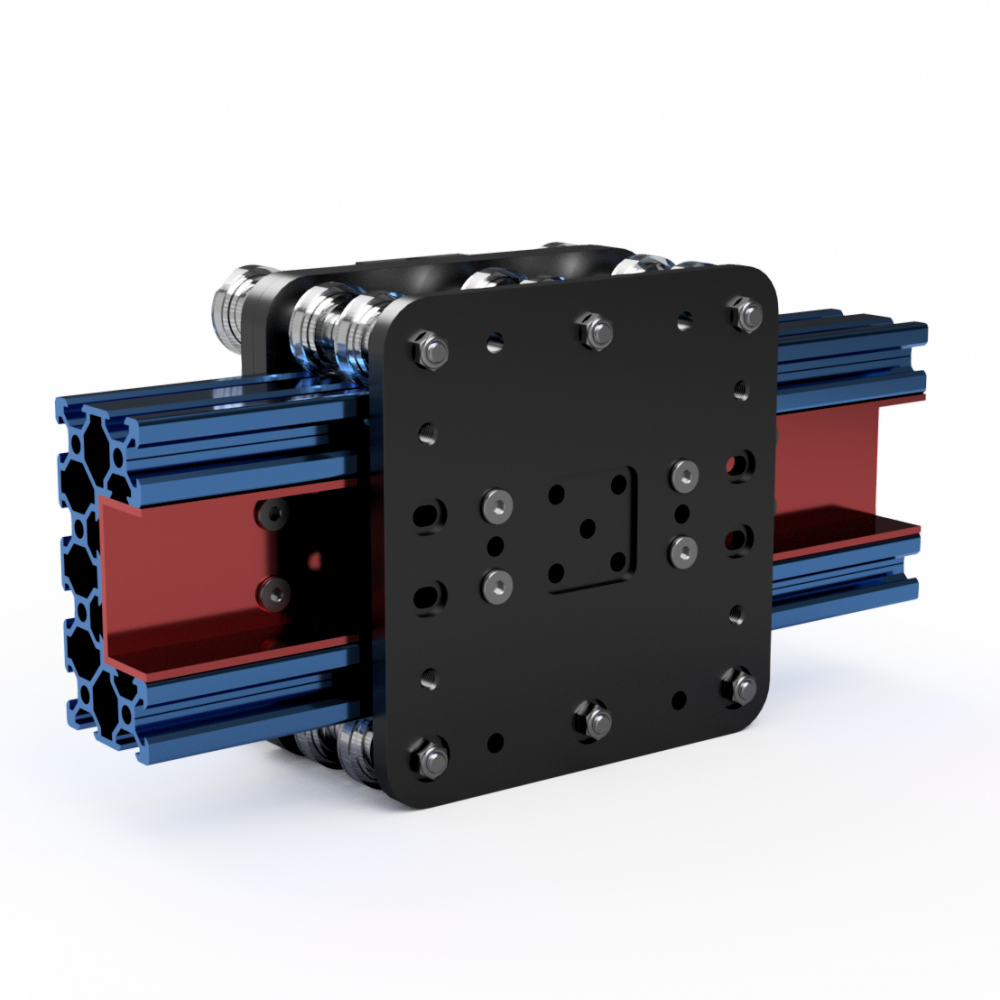

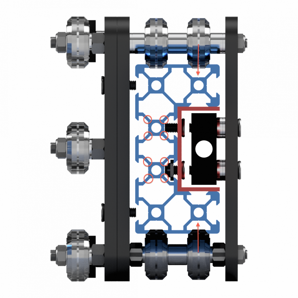

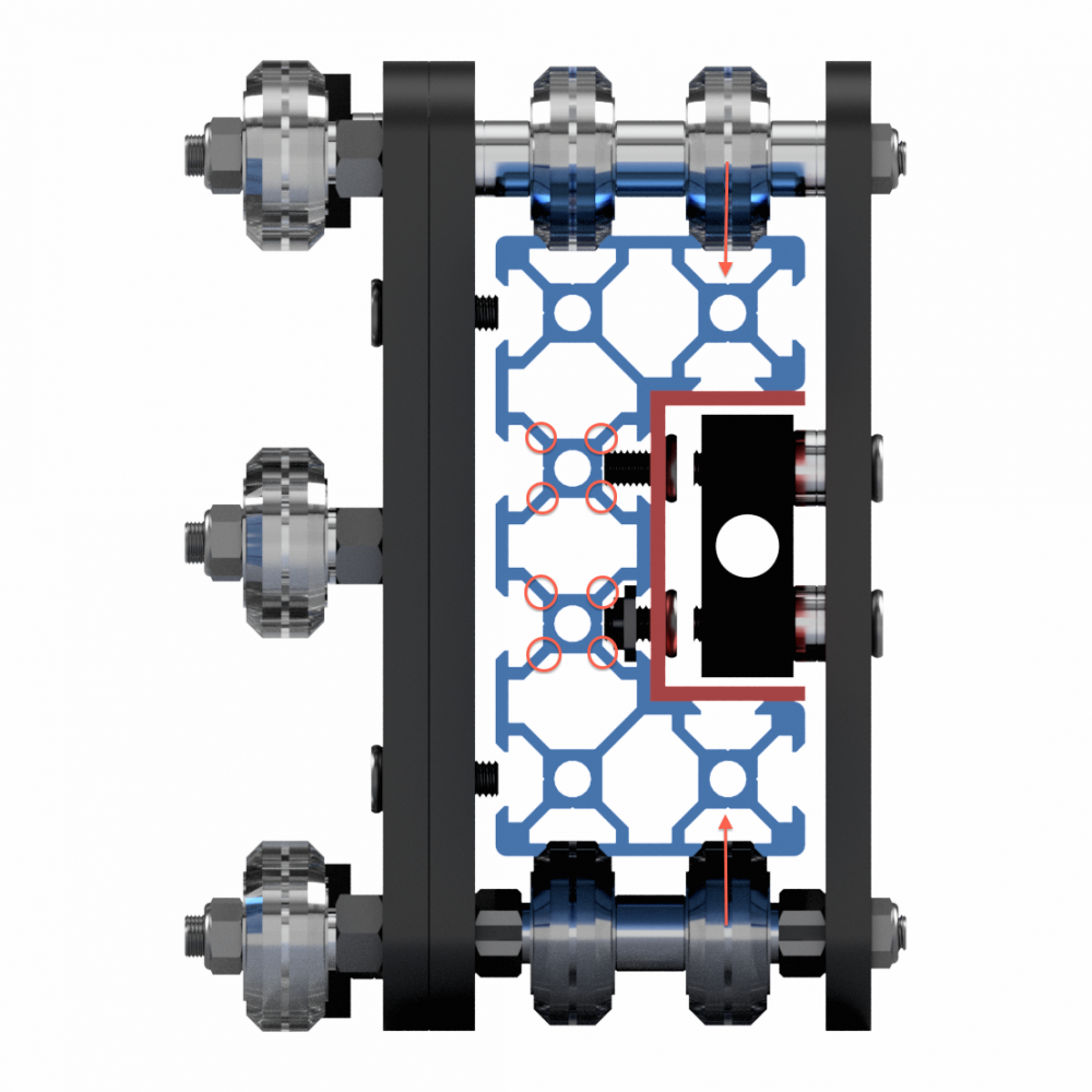

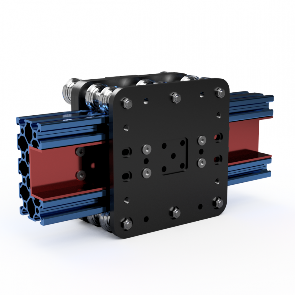

    A bit of an idea to add some extra strength to the C-Beam I had a while ago. The plan is to add a 40mm x 20mm milled aluminium channel with a 2mm wall thickness tied into the C-Beam with T-nuts and 8mm low profile M5 screws.
    Being same size as the inside of the C-Beam some sanding of the channel would more then likely needed to fit and/or a stint in the freezer. My thought are that it would strengthen the C-Beam at its weakest points (circled in the cross section above).
    Another wacky thought is to fill the four hollows with Plaster of Paris to add extra weight rigidity to this design.
    Your thoughts.
    GrayUK likes this.
  23. Rick 2.0
    2,862
    1,528
    You might consider moving the nut blocks outward 1 row of holes as that's what those holes were designed for. The elongated openings allow for a slight adjustment such that two blocks can mesh on the same screw thread. The recess also allows for a 20mm screw to be used.
  24. Moag
    Moag Veteran
    Mar 16, 2016
    183
    294
    Yeap I know. You miss nothing. I was was just playing around with fitting two of the anti backlash nuts blocks with the ajustments to the outside.
