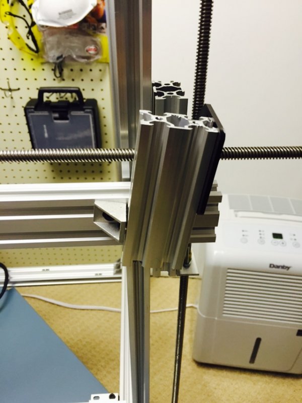

    So, I've got my ACME nut blocks (http://openbuildspartstore.com/8mm-lead-acme-nut-block/) and I've been trying to get them to move smoothly on ACME rods (http://openbuildspartstore.com/8mm-metric-lead-screw-acme/) for the past hour and a half (four pairs of nuts/rods).
    I did what advices I found here on forum suggested:
    - used a drill to work nuts out on their rods
    - bought graphite lubricant and sprayed nuts with it
    - then went on and sprayed rods the entire length (nuts are so tight they mostly clear lubricant off the rod)
    - used drill some more
    I managed to have one nut on one rod rotate smoothly (I can rotate rod with tips of my fingers, this is kind of resistance I've got on my current 3D printer when I rotate Z-axis rods) but others are still a pain in the butt to rotate.
    Anything else I could do to work out those threads in nut blocks?
    Also, what do you do to straighten ACME rods? These are 770 mm long and two of them have bends I can't really notice with a naked eye when looking down the rod. But when I rotate them in the drill they tend to wobble quite a bit.
    Thanks!
  3. nidal
    nidal Well-Known
    Nov 20, 2014

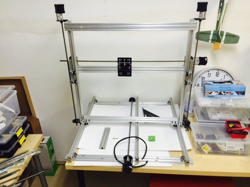

    This is what I did at the end to get ACME nut blocks moving:
    - There were 4 pieces, each about 25 cm in length, of ACME rods left after I cut them to required length
    - I chose one out of those 4 that required most force to turn nut block over it
    - Then I basically made thread tap out of it by cutting 3 notches at the tip with dremel metal cutting wheel
    - Threaded all nut blocks with this tap from both sides few times and it did remove very small amount of plastic out of them
    Now ACME rods can be turned using just fingertips. There still are some issues but it is waaaaay better than when I started.
    Mark Carew and Rick 2.0 like this.
  4. nidal
    nidal Well-Known
    Nov 20, 2014

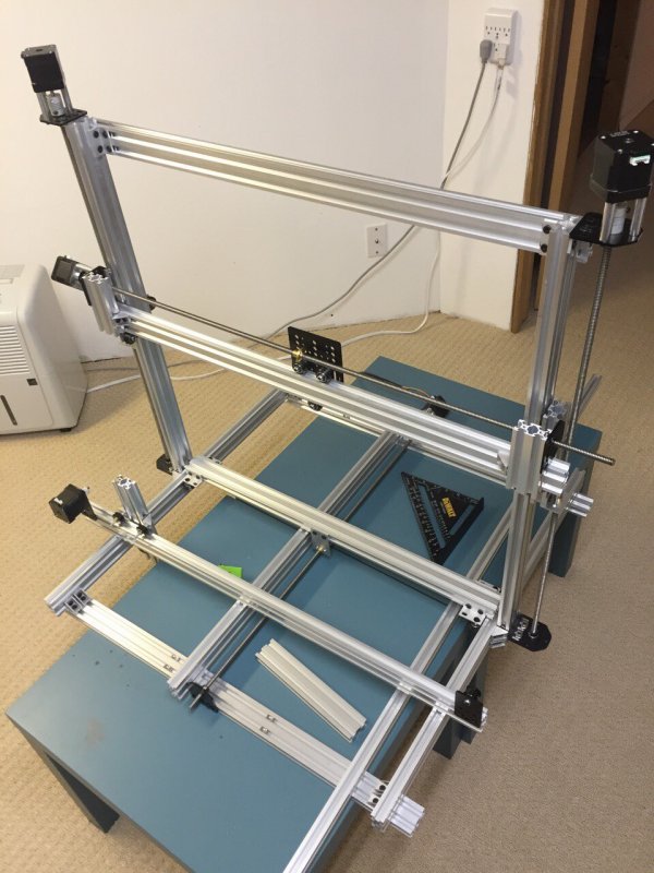

    All axes connected to gantry plates. Those nut blocks were, well, nuts :)

  7. nidal
    nidal Well-Known
    Nov 20, 2014
    Yes it's gMax, black and blue :) It's a good printer, I just haven't managed (yet) to get mine to print anything I could use in builds. even when I get parameters right, next or third print is off and I have to start calibrations and play with parameters all over again. Must be some mechanical issue.
    Anyhow, bed should roll on two 20x20 v-slots or maybe even on top of Y-frame 20x40's.
    I'm trying to make everything from off-the-shelf parts, so you could just order bunch of parts from openbuilds and/or some other store and put it all together without the need for 3D printed parts or custom made aluminium plates etc. However, it turns out that end price could be an issue with that kind of build.
    As for how the parts would come out on this big of a printer, well, the idea is to be able to print a number of smaller parts in one go. Put the plate on, start print, print finishes, take the plate with parts off, put the other plate on, take parts off of the first plate, and round and round you go.
    Also, you should be able to take the head off fairly easily and put some other on (i.e. DIY Dremel or not-so-diy spindle) and use it as a router for plywood, balsa and similar stuff.
    We'll see what happens with this one, but the way things are now (I have tried different setups, screws, belts even ball bearing screw for Y-axis), it seems that I will have to make some custom aluminium plates and brackets and use parts that you don't find in online stores that often.

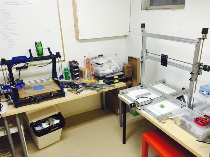

    Quick update:
    I have modified a frame a bit, but it is done now, all parts have arrived and are assembled:
    Extra v-slot beam is another version of X-axis drive using belt.
    Here is how maxbox frame compares to gMax:
    That window above maxbox frame fell of the other day due to strong winds and did some small damage on the frame:
    Nothing terrible, few notches and misaligned bits. Landlord came just an hour ago and nailed that ******* back into it's frame, no more falling windows! I hope...

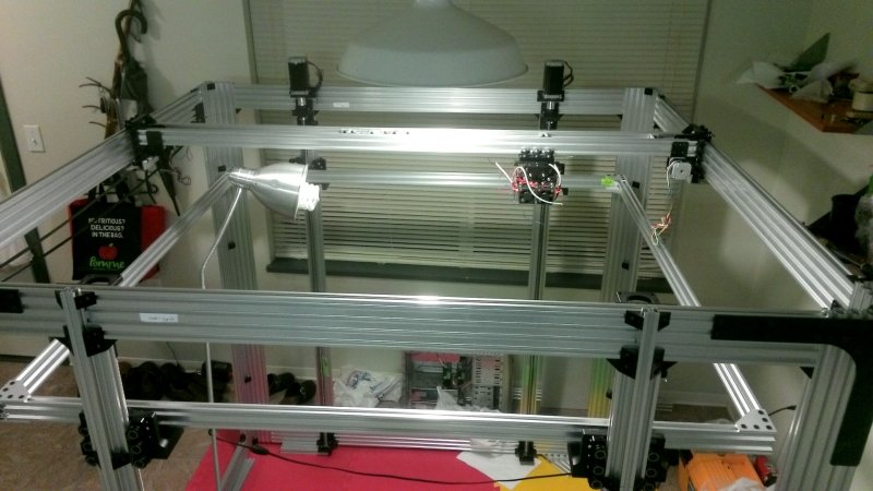

    nidal and Mark Carew like this.
  13. nidal
    nidal Well-Known
    Nov 20, 2014
    Can't fit into photo, eh? :D
    Nice!
  14. Val Cocora
    Val Cocora Veteran
    May 19, 2014
    172
    27
    if you only knew...
    had to climb a box to get it all in the frame. a nice cube, 1500 mm (59").
    printing area: 1270 x 1100 x 1145 mm (50 x 43 x 45 inch).
