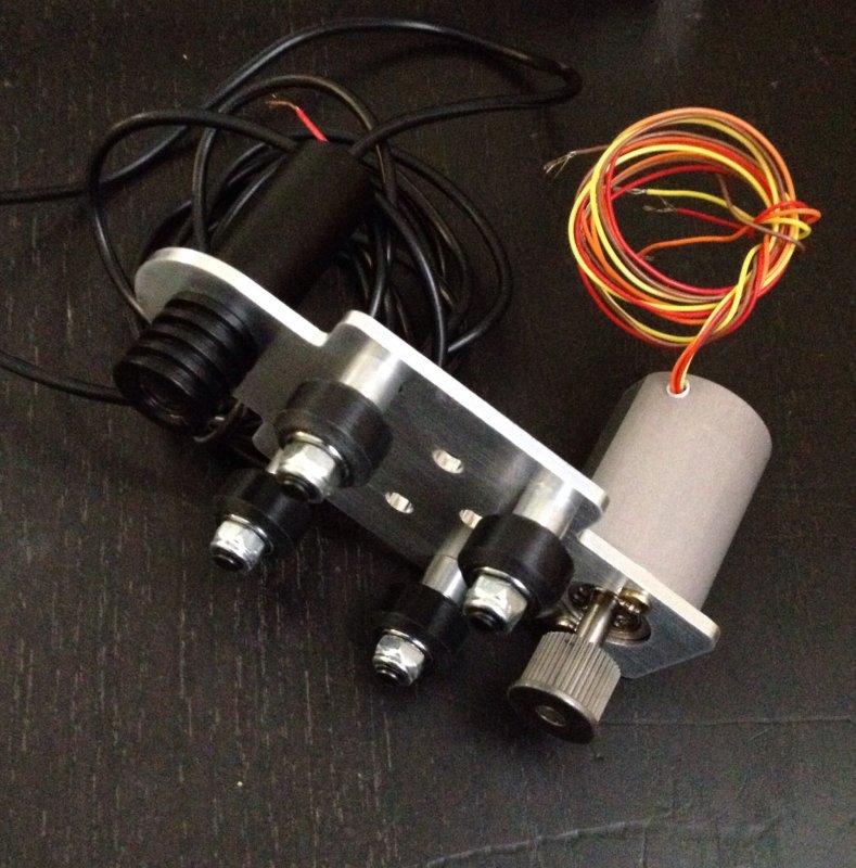

  2. Mark Carew
    2,746
    2,413
    Robert that plate in your last pic has got me excited about this build! and you use SketchUcam to make them how cool is that! great stuff keep up the good work the build is already looking top notch.

    Question; since your not using eccentrics did you move the holes in your plate design in so that you would have a pre-load already?
  9. Robert Hummel
    Robert Hummel Custom Builder
    Moderator
    Nov 14, 2013
    978
    714
    To tell you the truth I'm kicking myself in the butt for not getting some, I basically pre load them with light pressure then tighten. Two wheels don't move the others slide in to tighten on the rails when I pinch them/tighten, a lot more tinkering and adjusting to get things smooth :)

  11. Mark Carew
    2,746
    2,413
    Here's a little tip I learned while working on v wheels without eccentrics. With the gantry on the rail. If you can get a clamp across head of the screws (above the plate) and squeeze them together (I know it would be hard with these being low profile) you will create a slight angle then you tighten them down. What happens is the screw will want to line up straight to take the angle out and in doing so it will pull itself into the rail creating a pre-load :) Hope this helps

  14. Robert Hummel
    Moderator
    Nov 14, 2013
    978
    714
    Yes I'm using one motor for each axis , on the laser mount/rack there is no issues. On the x I did at first but got rid of it with adjusting the wheels. If I was to have a z I would use 2 motors for sure.
