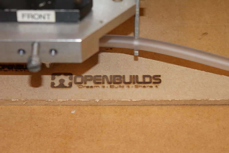

    I've modified the scritpt to scale the image at 10pixel/mm, try this:
  9. Tweakie
    Tweakie OpenBuilds Team
    Jan 18, 2014
    786
    297
    That's fine also but I don't have a problem with size (I can always scale the GCode at run-time). One thing that should be considered and as noted by Robert http://openbuilds.com/threads/laser-v.37/page-7#post-2237 - Ideally your generated GCode should have all moves following M03 as G01 and all moves following M05 as G00 with a feed-rate set at the start of the code.

  13. Robert Hummel
    Robert Hummel Custom Builder
    Nov 14, 2013
    978
    680
    G01 runs the set feed rate in your console
    G00 runs the set speed that $5 is set to in GRBL believe its "seek rate" not at pc right now
    I will run your code in 15 mins
  14. Robert Hummel
    Nov 14, 2013
    978
    680
    Ok here it is :)
    1 other thing is m05 must be the last comment or the laser stays on and after code axis don't home. see my changes

    Tnx @Robert Hummel , can you try this files:
  18. Robert Hummel
    Nov 14, 2013
    978
    680
    I will run them now :)
  19. Robert Hummel
    Nov 14, 2013
    978
    680
    5 gave best results, again M05 was not the last instruction so that is why the star had a fault

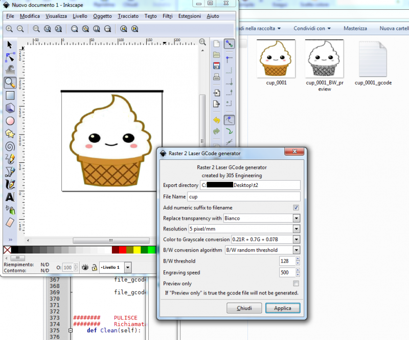

  20. oni305
    oni305 Veteran
    Jan 16, 2014
    106
    84
    Great!!
    Ok I'll add the option to choose the resolution on the extension. :cool:
    Now I've edited the script to add M05 & G00 X0 Y0 at the end of the gcode ;)
    Any suggestion on other options to add?
    Now the extension looks like this:
    Yusuf Tumer likes this.

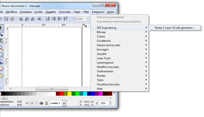

    So here we are, the release candidate of the extension!!!
    Require: Inkscape ;)
    Installing: extract the archive and simply copy all the files in the folder "Extensions" of Inkscape
    Windows ) "C:\<...>\Inkscape\share\extensions"
    Linux ) "/usr/share/inkscape/extensions"
    Mac ) "/Applications/Inkscape.app/Contents/Resources/extensions"
    for unix (& mac maybe) change the permission on the file:
    chmod 755 png.py
    chmod 755 raster2laser_gcode.py
    chmod 644 raster2laser_gcode.inx
    Enjoy,
    PS: to run the extension go to: Extension > 305 Engineering > Raster 2 Laser GCode generator
    EDIT: removed the file temporally

    just a side note: the extension export the whole inkscape document, so the first thing to do is to change the dimension of the document:
  29. Robert Hummel
    Nov 14, 2013
    978
    680
    I did that and am running a test print now, must say I'm impressed :)
    1 thing if it can be added is a browse button for file save location as most windows users are use to point and click.
    I will post the results as soon as it is done ;)
  30. oni305
    oni305 Veteran
    Jan 16, 2014
    106
    84
    Unfortunately it can't be added, inkscape gives only a few options for the GUI
    ( http://wiki.inkscape.org/wiki/index.php/INX_Parameters )
    Tnx ;)
