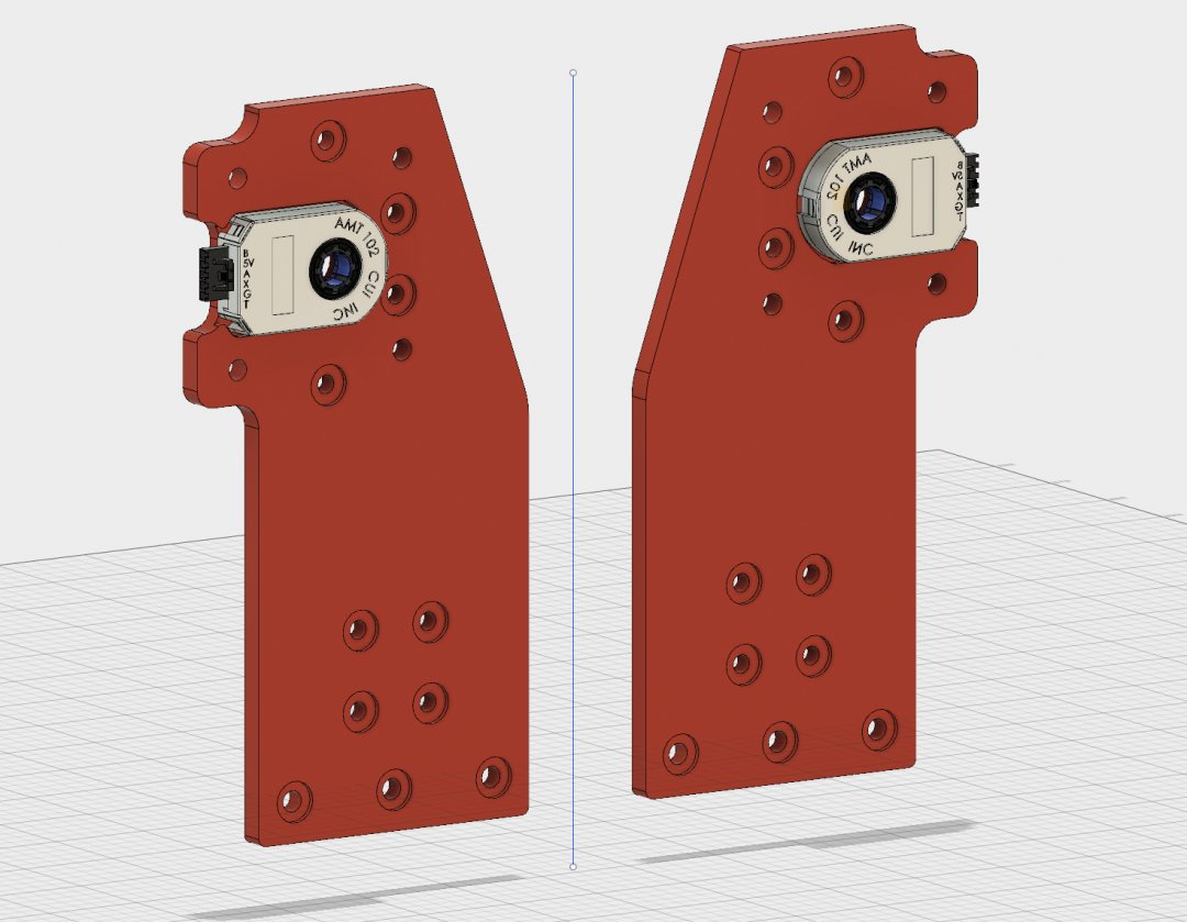

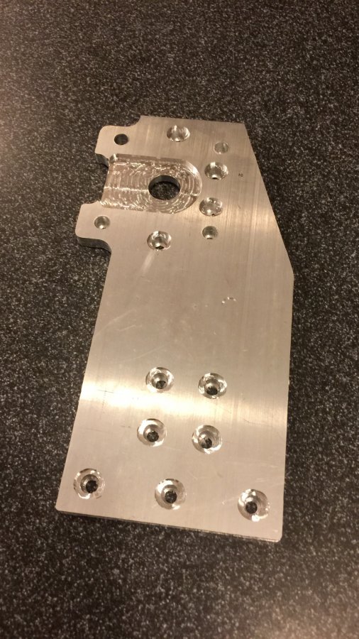

    Made a change on the type of encoders I'll be using for the closed loop portion of the build. I found this low profile radial encoders that are 2048PPR /w indexing.
    I changed up my endplates to accommodate them.

  27. Mark Carew
    1,902
    1,036
    Really neat encoders @ymilord I have not seen this style before. :thumbsup:

    @Mark Carew - It's a common type / Style. What new is the price point. That particular encoder is programmable. 48 to 2048PPR is 5000 RPM mode or 48 to 128PPR on 15,000 RPM mode.
    In the previous post I forgot to add this image. This was cut out on the Hog.
    Fusion 360 model.
    eddiejr and Kyo like this.

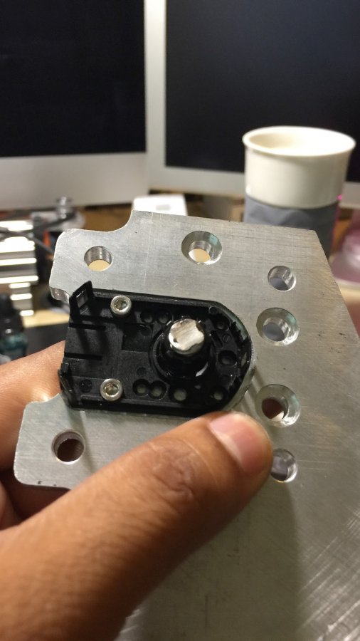

  29. Joe Santarsiero
    Joe Santarsiero OB addict
    Oct 30, 2014
    762
    165
    Neat encoders. I wasn't aware of this style either. Do they just clamp onto the screw?

    @Joe Santarsiero
    On the encoder end there is a 'socket' that mates up to the collar.
    The kits comes with adapters that can go from 2mm to 8mm.
