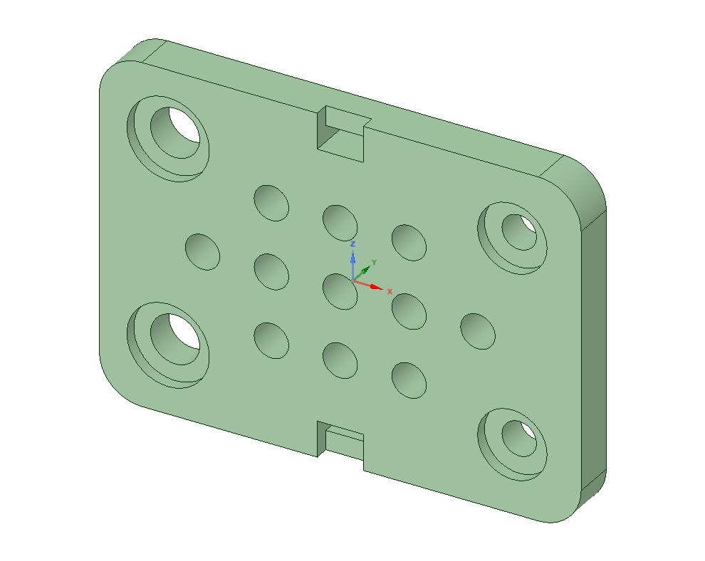

    Does anyone has sketchup model for the mini v gantry plate to be used on 2040 v-slot rail? I was going to use 2020 mini v gantry plate but I need the v-wheels to be able to ride on 2040 rails.
  2. Masao
    Masao New
    Mar 22, 2016
    Here is the model for the 2040 mini v plate. I designed using the Designspark Mechanical and exported to Sketchup.
    Nat972 likes this.

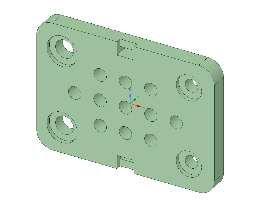

  3. Masao
    Masao New
    Mar 22, 2016
    Few more images.
  4. Masao
    Masao New
    Mar 22, 2016
    Thanks, I'm thinking about using as X gantry plate to house my CO2 laser focus head. I wanted to keep it compact so that I get maximum movement on X axis travel.

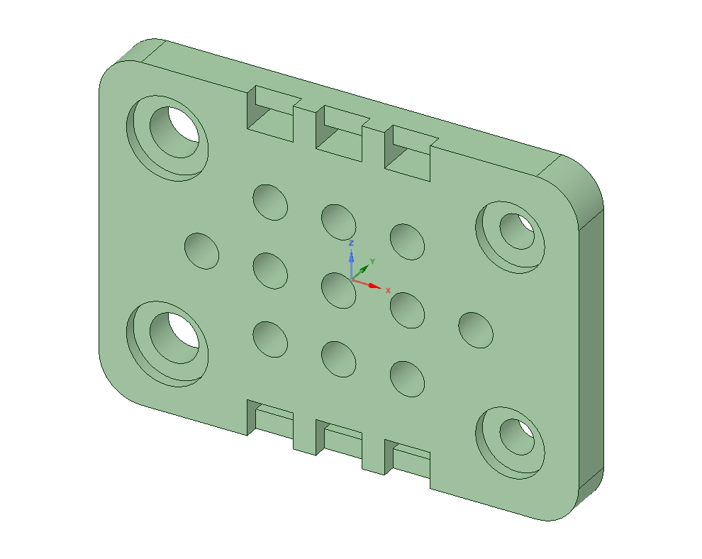

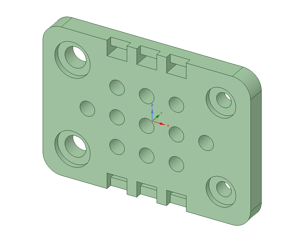

  5. crispin
    crispin New
    Jun 21, 2016
    49
    Yeah! Add a 3rd hole between the existing pairs for an additional *centered* belt-attachment option.
  6. Masao
    Masao New
    Mar 22, 2016
    Here are versions with centered belt attachment.
    ArrArr, crispin and Grantman like this.

  8. Giarc
    2,923
    1,620
    Eccentric spacers need the larger holes.
