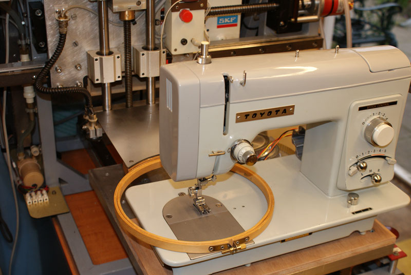

    Hi, Thanks for the positive remarks :). I guess I must have spent about £150 with most of that going on the relatively expensive (but excellent) V-Slot parts. I started about three months ago - but most development was done in the evening while the wife was watching TV!

    Great job and excellent quality. I think I will start similar build as my next project. However, I think to base on common CNC/3D printer board, such as RAMPS, that will understand G-code, and will try to integrate with Embroidermodder project to be able to use any available design file found on the internet. I have an old Soviet German Textima Veritas sewing machine in very good condition. But it should be used with 2:3 duty cycle, so I think, I should include duty cycle configuration into the software, to not to overheat the machine and drive.

    I think I have now got to grips with the Tajima file format (which appears to be one of the insdury standards) so everything is looking good so far. Now to read the manual to find out how to thread the sewing machine and the first test run may be imminent. :)

    I will have to start another thread on this topic because machine embroidery it is a lot more involved than I had first envisaged.
    Here I have used a standard Tajima test pattern and have ignored the thread colour changes just to test that the machine set-up works OK (I trust no one notices that the washroom roller towel has become a bit shorter :)).
    Now comes the software learning part in order to produce my own designs. ;)
    Tweakie.

    Are you controlling the speed using an AC controller? and I wonder how you are detecting needle clear?
    Great work.

    Thanks for the heads-up on Janome. I have not had time to investigate the various ‘industry standard’ formats yet – something for the future. :)
    At present, I have two different machine / software control systems and I am currently comparing the merits of each against the other.
    1) Stepper motor and toothed belt machine drive where the software is in total command of the machine’s needle position and work movement.
    2) DC motor, continuous, machine drive - using a slotted disc and opto-switch where the machine is in command of the work movement. I don’t know if this is typical of all machines but I have 40% of the machine’s rotary motion where the needle is well clear of the work so the opto-switch tells the software when to move the work.
    Tweakie.

    Just brilliant ... but i still dont know how you detect the position of the needle with spring steel ???? kind of a switch ?

    Fortunately, the machine completes one stitch for every revolution of it's main shaft - by using an opto-switch it is possible to sense the rotational position of the main shaft and thus the needle position.

    Thanks Tweakie .... understand how you identify the position with the opto now :banghead:... over looked the fact that you were using a stepper motor to control the sewing machine ... :duh:

    It's not necessary to use a stepper motor to drive the machine, although it does work - it's just knowing when the needle is clear of the work (and the opto-switch does that) so that the X-Y movement of the work can take place. The problems I have encountered relate mainly to stopping the machine rotation when the required X-Y movement is greater than can be done within the available time-frame of one complete revolution. Basically it limits overall speed (stitches per second).
    Professional machines have cracked this problem and I am sure it is only a matter of time before I discover their secret. ;)
