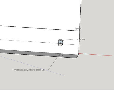

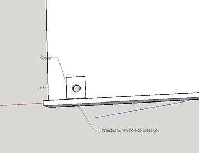

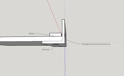

    What if you cut slots in the gantry plate where you normally had larger holes for eccentrics. Then, make 1/4 inch spacers with normal diameter holes for the axles that line up with the slots. Using angle at the bottom of the gantry, tap holes and have screws that screw perpendicular to the spacers pushing on the bottom of the spacer forcing it up.

    Here are a couple screen shots of a VERY crude drawing. The wheels and axles are missing, it was just done to illustrate my lamely described concept above.:)

    Yeah, I was thinking about that. That's the way they do it on the larger machines that use 6 or more bearings that run on cold rolled steel flat rails, like CNCRouterParts.com, and finelineautomation.com.
    But what's the angle piece for?

    I was just trying to think up a quick way to make the screw that raises or lowers the spacer perpendicular so it could push on the bottom of the spacer do make it go up or down. It doesn't need to be a threaded angle. There are other ways to do it. That was just three different views of the same thing.

    Craig:
    I gave that some thought. It might work, but there is one flaw: The axle bolt is in a slot that is parallel to the major force on the wheel. This means that there may be a significant twisting force on the wheel/axle, and there is nothing to support it in that direction because of the slot. Also, the setscrew acts as a fulcrum. The only support it gets is from the bolt head and the spacer which are flat surfaces resting on the perpendicular faces of the plate. Might be ok, especially if these flat surfaces are larger.
