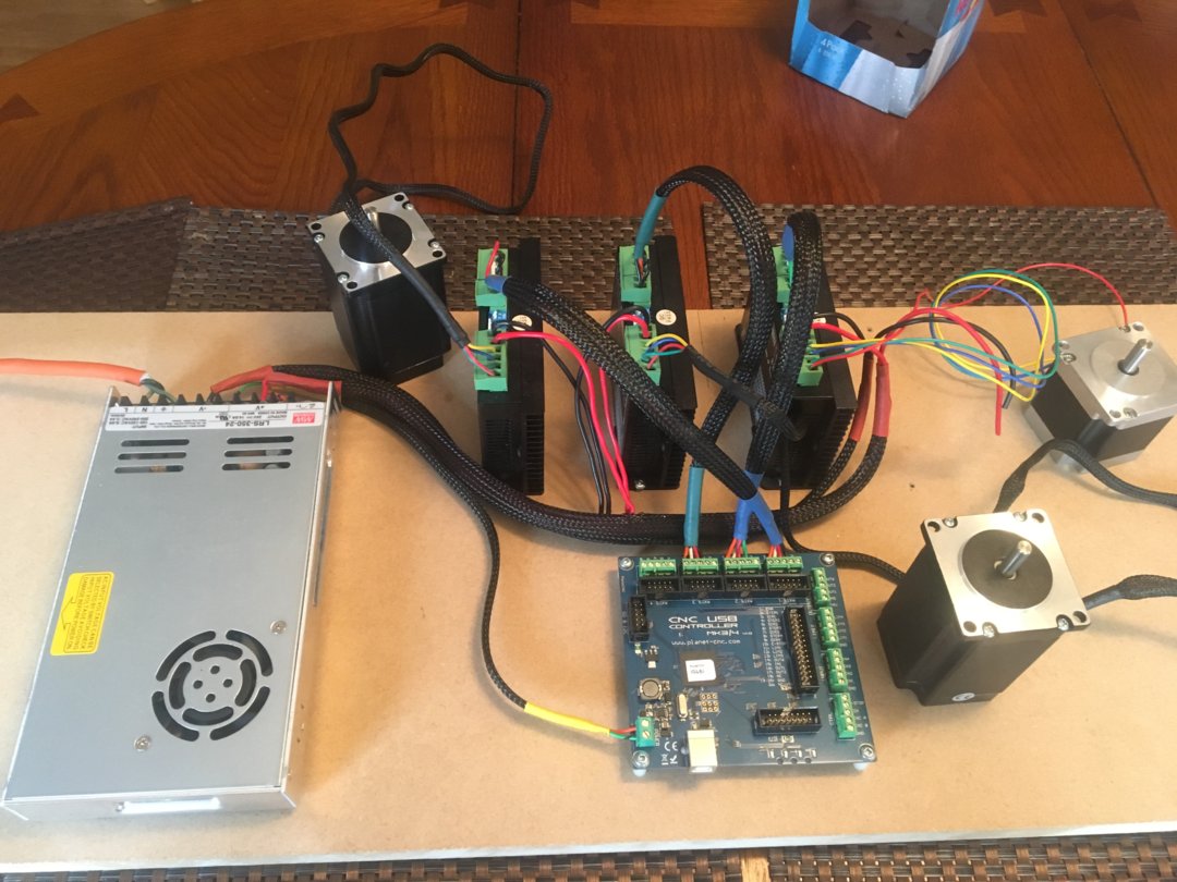

    Why would two of my drivers (DQ542MA Stepper Motor Driver), one for x-axis and one for y-axis, both fail when my machine is not even being used, and i mean its not even powered on.
  2. Joe Santarsiero
    Joe Santarsiero OB addict
    Oct 30, 2014
    807
    167
    Good question Ren. How do you know they have failed if you haven't powered them on?

    Aside from a power surge or back flow from the steppers being moved by hand it's not likely the problem occurred while the system was turned off. It's more likely the issue occurred with the last power off or the most recent power up. What have you done in the way of troubleshooting to help isolate the problem? (Swapping motors/drivers, tracing wires/checking for shorts, etc.) Also, what type of board do you have them plugged into?
  5. Ren Copeland
    Ren Copeland Well-Known
    Dec 18, 2016

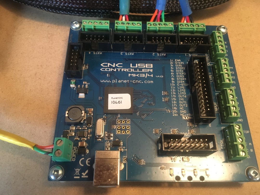

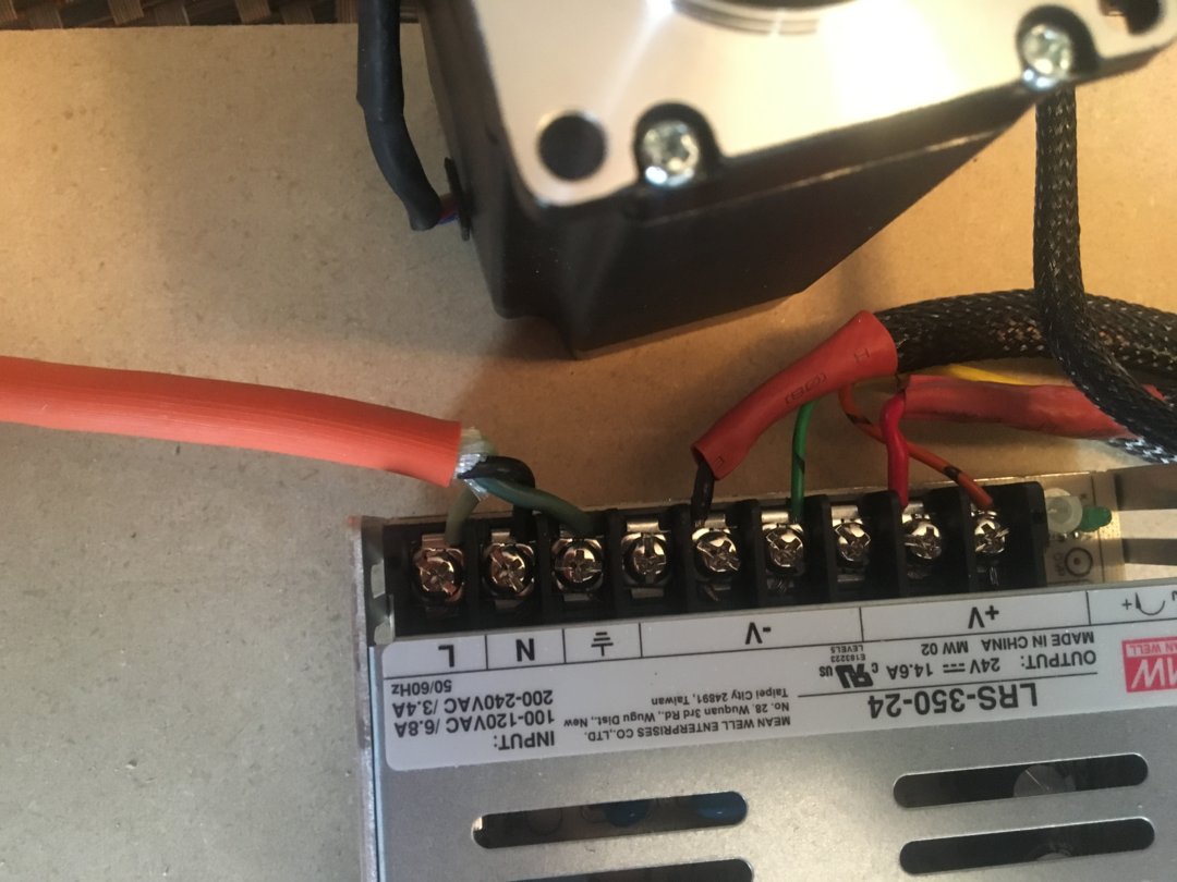

    To eliminate the possibility of faulty wiring, I left the power and ground wires screwed into the terminals of a driver that is working. I removed the plug from the driver and placed it into the driver that was not working and it would not power on(no leds). They are plugged into the Mk3/4 board offered on the openbuilds part store and the powered with the 12v power supply from the part store.

    no lightning storm. and i don't have a cycle count, i would venture to say 50 or so cycles. after inspecting the units, it looks as though they overheated......which would make since seeing as i have them in an enclosure.....and failed to include any fans.

    Good day All,

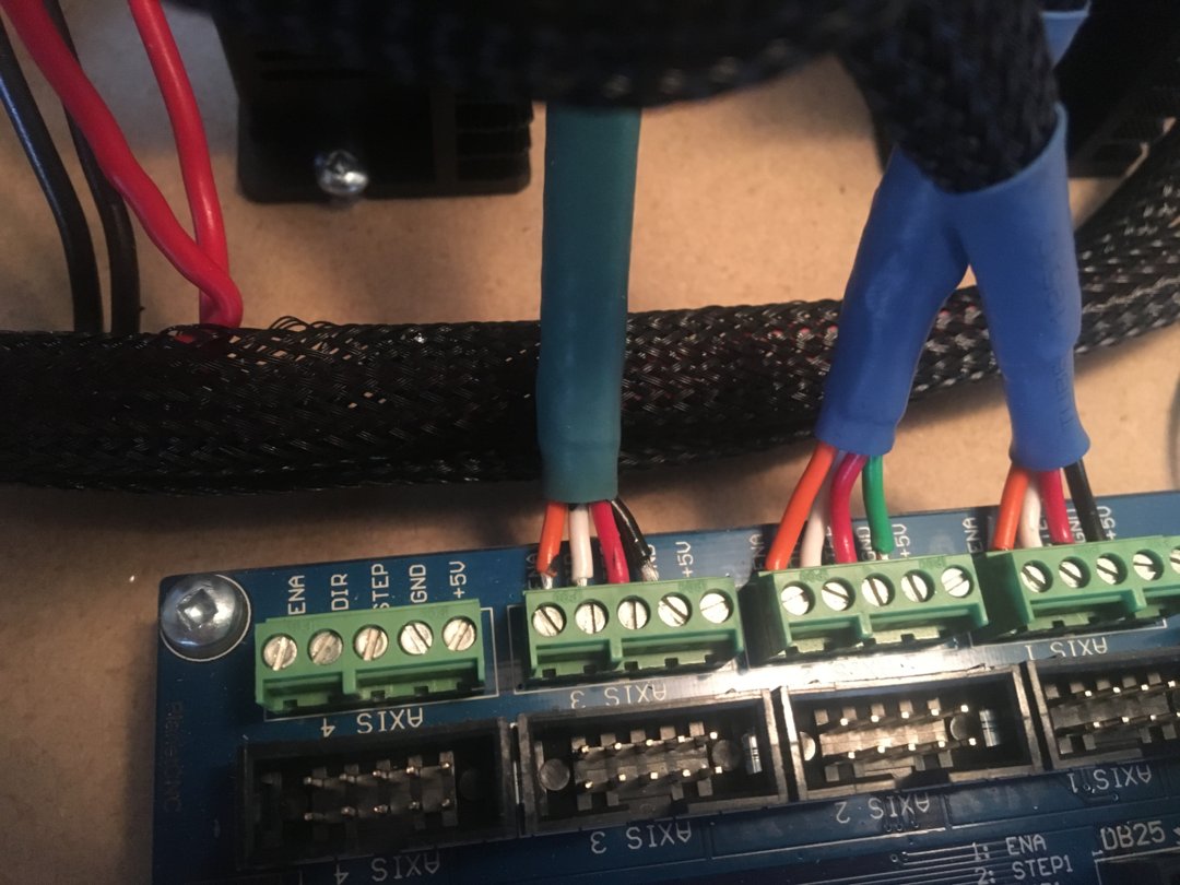

    I'm hoping to get a little advice on an issue I am having with my stepper drivers. I started to put my electronic controls together the other day and everything seemed to be going well. Once I got my control board (MK3/4), Stepper drivers (DQ542MA) and motors (Nema 23 high torque) placed and wired, I ran a test. I found that only 1 of the 3 motors actually functioned properly. All the lights on the drivers came on with a solid green but 2 other circuits did nothing. I swapped motors and all 3 worked on the driver that was working. Then i swapped the drivers from axis to axis to make sure my control board worked. All axis turned the motor/driver combo that was functioning but failed to turn the other 2 motors. I have a 24v 14 amp power supply connected to the drivers and also the control board. All the components are new, this is the first time they have been assembled and powered up. My wiring connections are as per the instructions for the DQ542MA driver using the Yin (Fig 2) schematic. I have a 2K resistor in series with each of the Pul, Dir and Enable +'s, and my dip switches are set as follows 1-off, 2-on, 3-off, 4-5-6-off, 7-8 -on, with the exception of the last driver on the right as it's motor is a 1.6 amp 400 step nema 23. I'm not sure what other info i can provide at this time but any advice is greatly appreciated. A few pics of my wiring are included. IMG_0093.JPG IMG_0094.JPG IMG_0095.JPG IMG_0096.JPG

    I can tell you that i did not use any resistors in my wiring.

    Ren,
    Thanks for the advice. I rewired the drives excluding the resistors and the enable circuit. Things are working good now. All drives function and my speed is up to where I expected.
