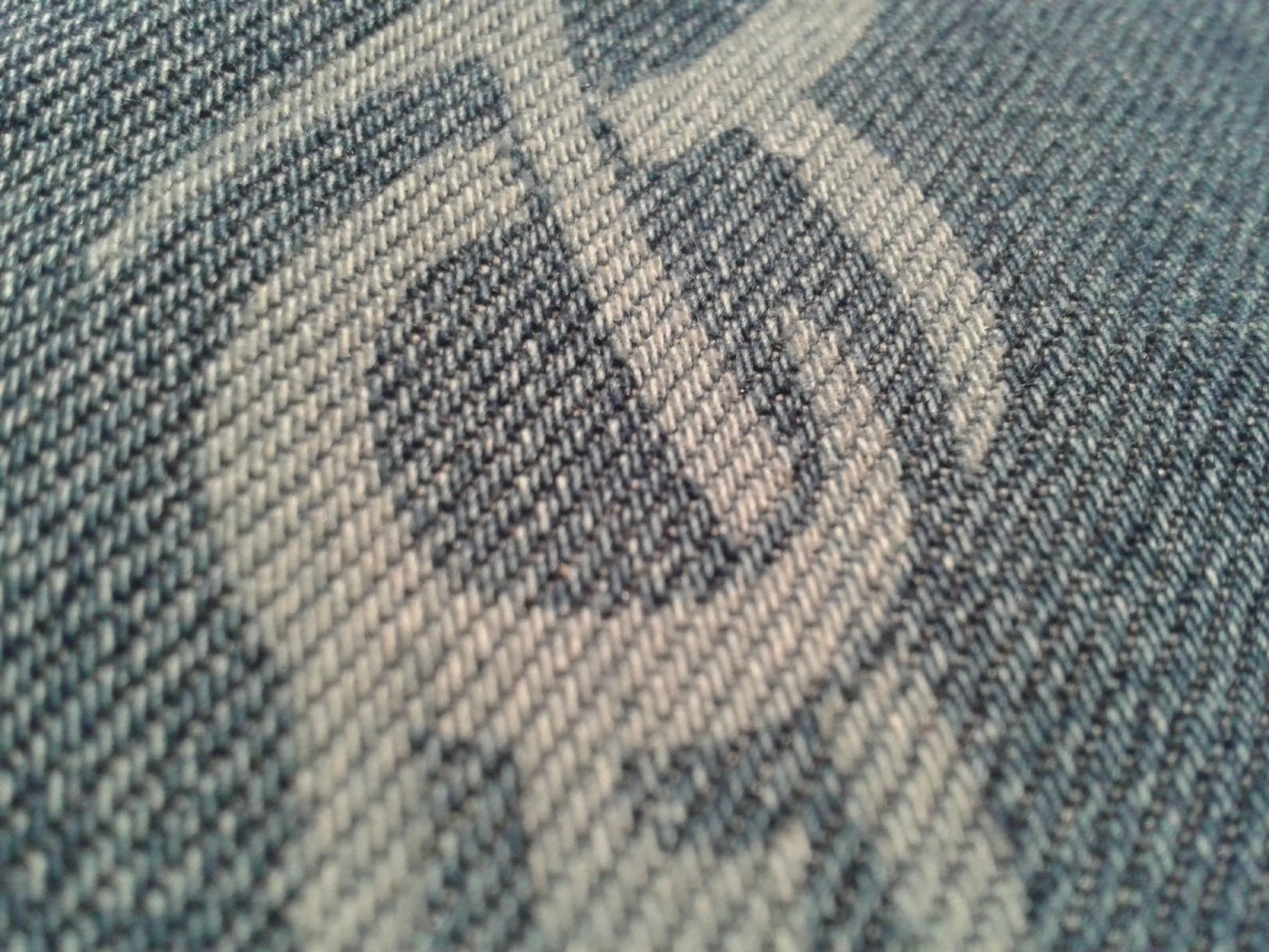

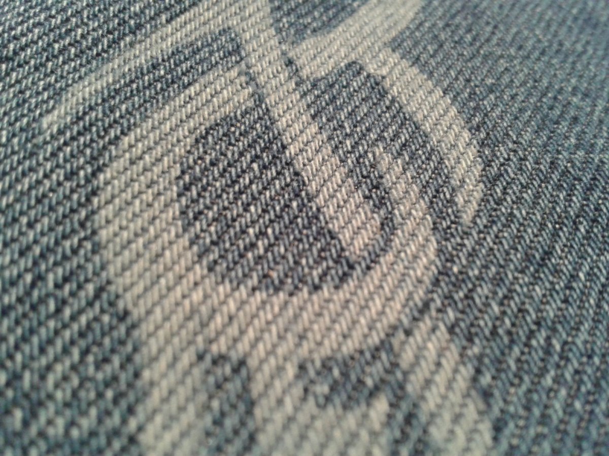

    Hello Mohamed,
    I have been engraved some jeans, but I find never "suffer and weak texture problems after the engraving process".
    The following picture shows a zoom photo from the jeans texture.
    At time, I made the engraving test only on jeans.
    A patent may only be registered if the invention is novel.
    Here are Youtube videos from a high end Laser solution.
    My solution is just one way for home users, to design/ engrave his own jeans.

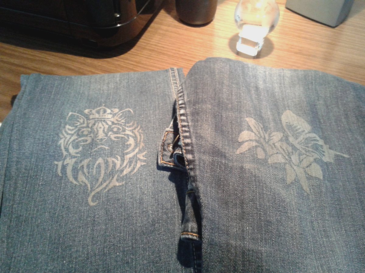

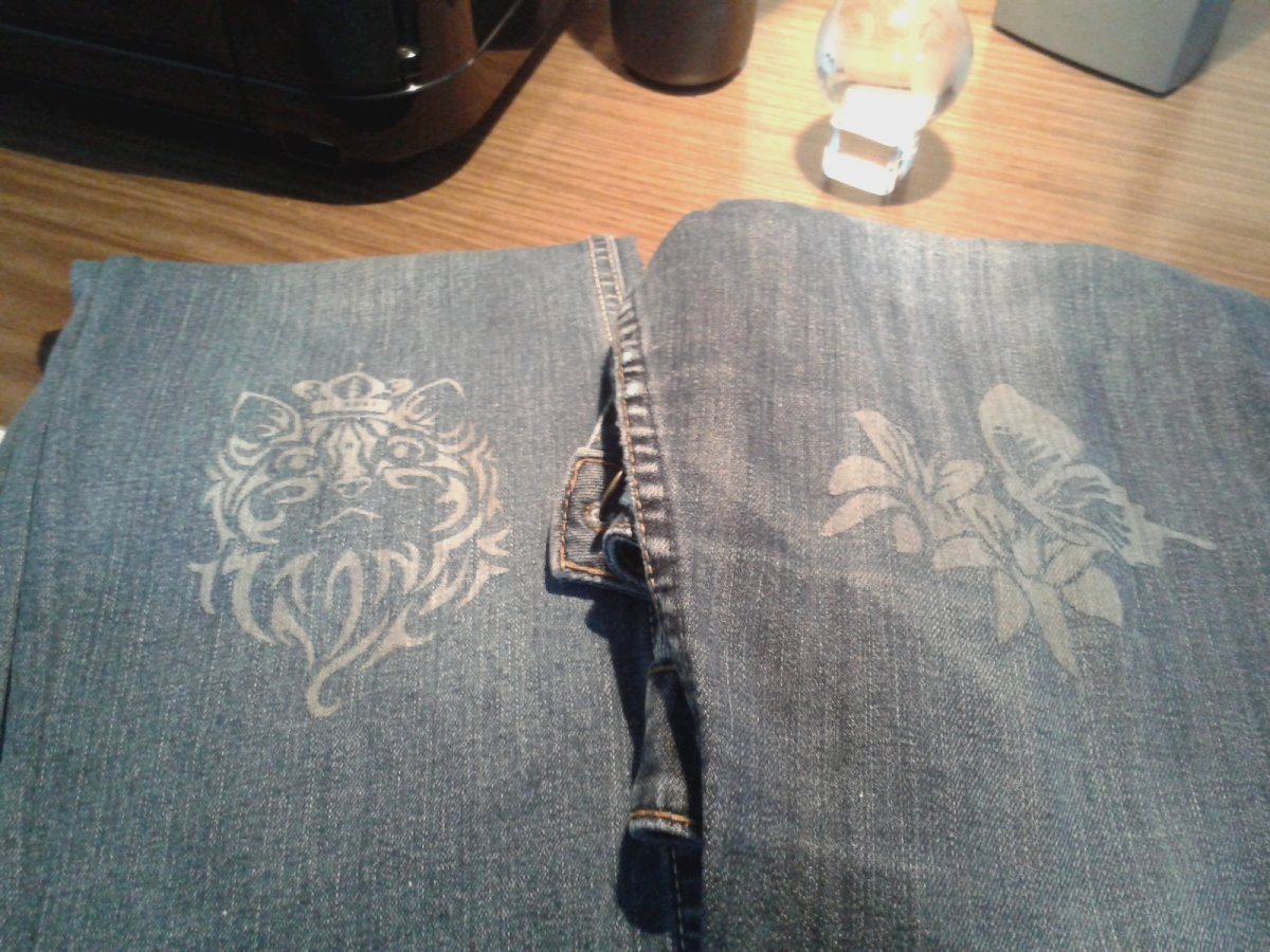

    77
    Hello Becky,
    yes, I have another video how it works to engrave a flower on a jeans. :)
    20151226_131355.mp4
