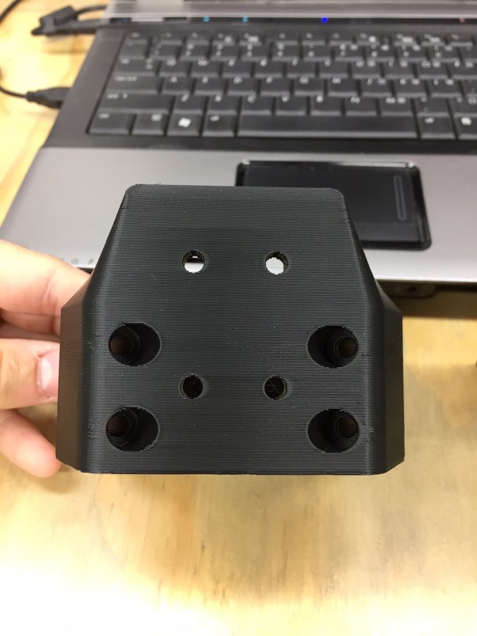

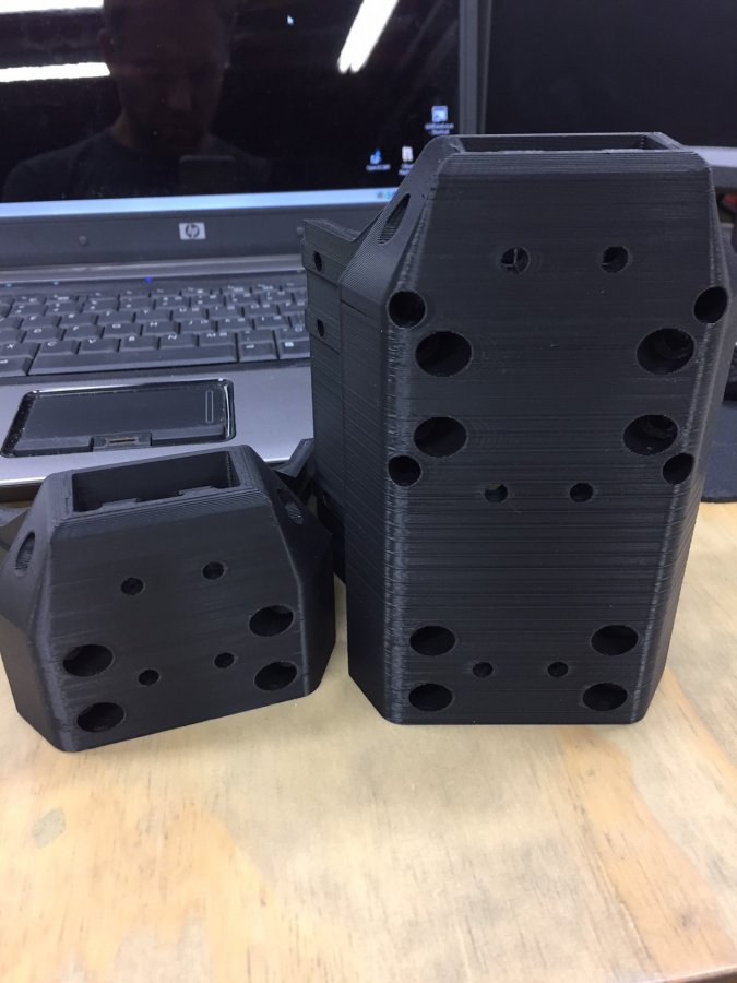

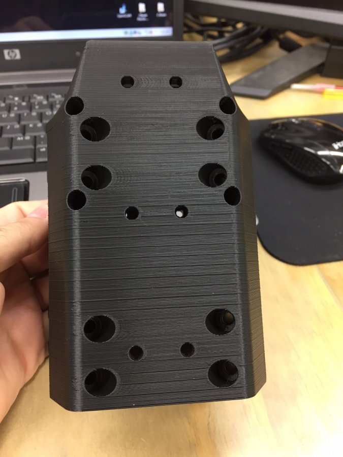

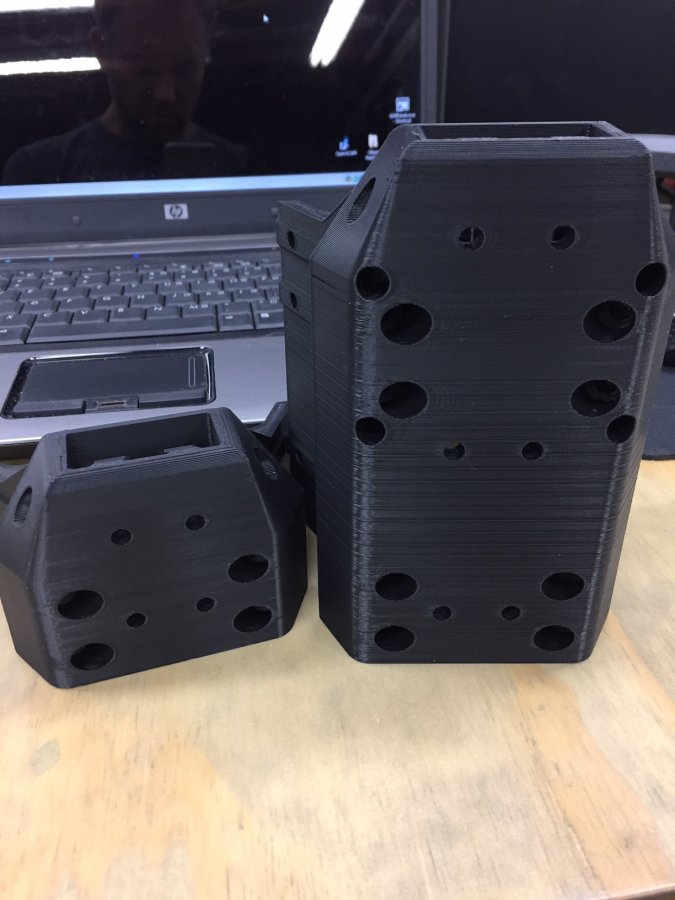

    Can you post some pictures of whats different about yours?
    I have already started printing the Delta-Six vertex pices but i think im using yours. They are the double bottom vertex and single top.
    The double vertex has Z lines that i fixed in my printer as you can see they are not in the single vertex i printed after the double.

    Jerry's take on the Delta-6 didn't have a separate build thread. Since I'm building one, figured I should start a new thread to keep this particular buildlog well organized.
    At this point, I've printed 3 large vertexes, 3 small vertexes, 3 carriages for big-V-wheels, 3 carriage arm mounts, 3 belt tensioners and the spool holder.
    I still have to print the bowden extruder + effector ( or figure out how to make a direct-drive extruder that fits this design on the effector )

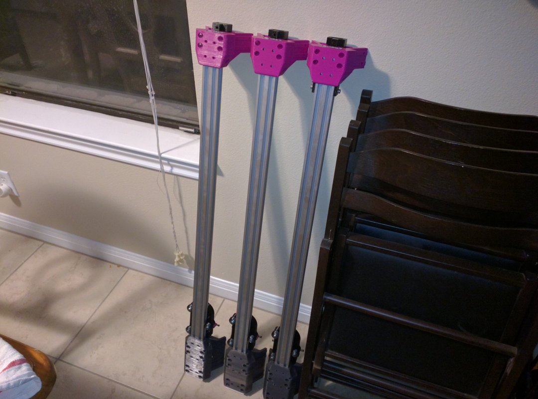

    Productive weekend so far! I have dry-assembled the carriages onto the rails, and tested the fit of the vertexes. I've got a @#%-ton of bolts & nuts coming via Amazon on Monday, and I had to buy three more pieces of 20x40 500mm rail from OpenBuilds to finish the sides of the towers.
    I need to figure out the 'ideal' length for the arms once I have the effector printed. My bot is using 500mm sides, and the effector that Jerry designed w/ Traxxas ends. I'll be using a 300mm borosilicate glass bed, with the SeeMeeCNC heated build platform underneath it and bonded with the same 3M product LulzBot uses to join their heater to the glass for best thermal conductivity. I may add a PEI sheet on top, as I've had very good results on the LulzBot TAZ 6 w/ PEI.

    Hey James,
    What is the cause of the banding on your tall vertex print? It looks like it's happening every 5mm or so in the Z axis?
    -Martin

    More progress! All the carriages are mounted, idlers are mounted, and all the parts for the vertexes are finished. All major components have been printed, and I am just waiting on Amazon to deliver the hardware needed to bolt it all together and OpenBuilds to deliver the cross-pieces I need.
    Servos are ready to go, and I even got some of those nice "quiet" mounts for them. RAMPS 1.4 board and LCD are also programmed and ready to go. 24V power supply is ready, e3d v6 w/ 24V cartridge is ready.
    Now, all I need is to choose an auto-leveling system for this build.
  7. James_Hopkins
    James_Hopkins Well-Known
    Jul 16, 2015
    19
    Im not sure what was causing the banding but i think maybe the 8mm threaded rod was bent or something to do with the aluminum coupling between that and the stepper motor. But now its all gone since i replaced it and added a reduction pully.
