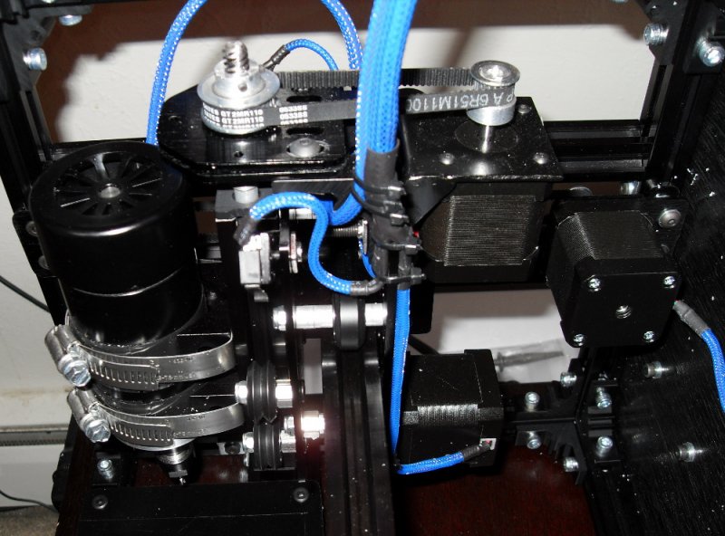

    andrew published a new build:

    WOW please tell me you are going to be sharing a parts list and instruction for this build!
    Great job looking forward to seeing some cutting videos as well :thumbsup:
  3. Anthony Webb
    Dec 30, 2013
    23
    Really interested in this as well, Where are your stepper hiding and what kind of spindle do you have?

    Thanks guys. I'll try to get a sketchup model together when I have time. The steppers are a bit hidden. I tried to arrange them in the best way possible to use the limited space. The z-axis stepper was moved to the back of the gantry to counterbalance the spindle and reduce height. The spindle is the 400w dc model commonly found on ebay.

    Very nice. Seems like the work area is larger that the 14cm x 14cm you've indicated. Maybe its just the photo. Whats the Z axis range ?
