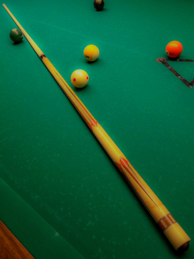

    Thank you...I was machinist for many years as well. One of the reasons for making this is I missed making things. My cues will just be MC (McCool Cues). I have only made one so far...building the matching jump cue now. I have to decide if I truly want to make them as a product yet...perhaps not until retirement. Dream Come True.jpg I play with it daily and love it as much as any cue ever held. Beginners luck I am sure. Those points are cut in...assume you know what that means. Everything was cut by CNC except the drilling and tapping for joint...but also done on this machine.
    I have been making many fun things to learn the software and machine in all it's capacities. 2D, 3D, 4th axis, engraving, V-Cut, Inlays...etc. All have turned out very well. Accuracy to me is phenomenal. Not like a true machine tool but it is not the fault of the round ways...they provide quite enough rigidity. I have machined new mounting plates in aluminum with good surface finishes, I feel I can hold .001 to .002 but have little need for that in wood (except inlays). Indexing is spot on out to 10 full revolutions at my max radius of 8"...so beyond that will be close enough for anything I do. Mach 3 really helps with that. Main issue I still have is keeping the gantry aligned spot on. I need to figure out the gantry squaring functions with home switches and the way my controller is wired. There is no traditional breakout board and the LPT wires are individually spliced in...what a pain. So I still have some faulting and then the gantry is no longer square. I am really good about restarting in the middle of a cut. ;-) Once that is figured out the lathe at front will be a lot more user friendly. Having the lathe run in the Y direction would allow more accuracy I think as the squareness of the gantry has less affect then. There are some Chinese designs out there with a cantilevered gantry that runs out to the side mounted A-Axis. If I were to do it over I may opt for that...although it is a super handy now. Thanks again...good luck with your build.
