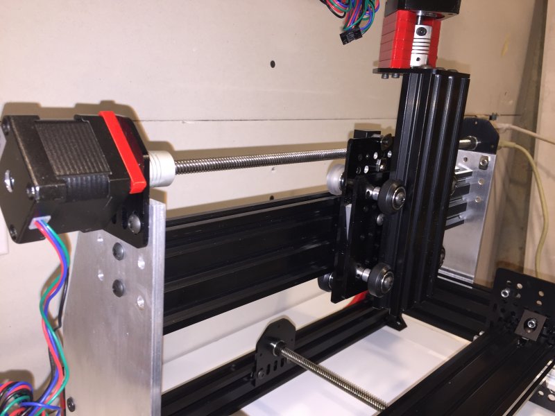

    A comment about my gantry. I really struggled with the plate configuration. My goal was to use parts store parts, since I felt the OX plates were a little overkill for this machine, and I didn't have the same confidence in drilling the wheel holes precisely. While the side gantry plates were easy to drill using a laser cut template, the wheel holes need to be just right. The primary goal was to keep the spindle as close as possible to the gantry, to keep flex down when the Z asserts force down. However, this was easier said that done and I built/rebuilt the configuration about 20 times. I ended up using two small pieces of 20x20 to space the plates apart, and I angled them to get better hole alignment and rigidity between the two plates. I think this could be done with a single plate that is about 20-40mm wider than the current plate, and spacer blocks for the Z axis. I may use the current configuration to cut one out.

    Nice looking machine! It seems like a good DIY alternative to some of the new, small form-factor machines like the Nomad and Othermill. What kind of travel are you getting on the Z and how's the rigidity? I'm hoping to get 5-6" on the Z-axis, but I'm worried about too much flex. Also, how are you attaching those linear bearings to the extrusion? You mentioned clamps. Do they just bolt on?

    I have about 2" of travel on the Z axis, but for this setup, that is plenty. The intent is to mill mostly small things: circuit boards, jewelry, small parts, etc. The 12mm rail is bolted right onto the v-slot using standard 12mm mounts. Scroll up on this page and you'll see some photos and notes about it.
    Oh, and for the linear bearings, they are attached to the v-slot gantry just using pipe strapping! I folded the ends of the strapping over to make it a little stronger on the ends, then made it the right length to be able to have lots of tension on it with the bolt about 2-3mm off the surface. The V-Slot keeps the bearing perfectly aligned.
