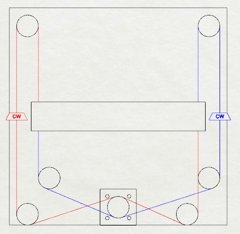

    I am thinking about doing what I would call a Core Z axis. I added the counter weights to prevent the slamming of the table if power loss. It would only need one motor.
    Edit: bad design. See below.

    after sleeping I figured out this design was flawed.
    Here is the correct Core Z design.
  14. Carl Feniak
    Carl Feniak Master
    Mar 18, 2014
    648
    215
    Yes, this revision will work much better! ;)
    What is your end goal though? Reduced cost? There will need to be two pulleys on the stepper motor shaft to offset the belts since they cross.
    Another option for a one motor set up: you could rotate the motor 90 degrees and shift it to the right or left. Then attach a bed length bearing confined shaft via a flexible coupling and attach two belt loops to it (looping over a pulley at the top like you have). You would still need counter weights as well, but this would keep the belts in alignment, reduce geometrical complexity, and increase belt contact with he drive pulleys.

  17. Carl Feniak
    Carl Feniak Master
    Mar 18, 2014
    648
    215
    Have you thought about using this with fishing line (maybe that was your plan all along)? I only imagined it with GT2 belts. You could have the bed home to Z max (bottom) rather than at the top for when it is turned off, plus there could be a rubber or spring stop at the bottom to cushion a fall on power failure. The belt cross isn't an issue with fishing line since it is so thin and has to spool anyway.

    I was going to use GT2 belt. and have the home at the bottom. also I will be hooking it up to a battery backup as we have brown out about once every other month.
