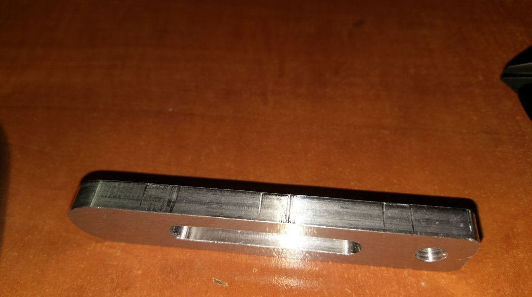

    The question is about cutting aluminium.
    I was already trying different aluminium (6061, extruded) different end mills ( some expensive 1 flute upcut end mills from Amana Tools, some cheap 2 flute end mills from ebay....) .
    What can I say...
    Yes, C-beam machine cuts aluminium. But I can not get an acceptable cut.
    What I mean for acceptable? well, some typical metal shining, absolutely smooth and even , like polished cut, which I saw many times on big milling machines. The cuts, coming from big milling machines, looks like mirror, they do not need any sander or file or something like that.
    My machine is C beam, spindel is Bosch PR20EVSK Colt Palm.

    To be honest, the edge on the first cut looks really bad. The mirror was there, but the waves are terrible. I was able to get a better finish on my hdpe based CNC shark (which I greatly despise and am replacing right now). My settings were much slower. My endmill was also dirt cheap. I want to say I was around 360mm/min with a 0.3mm DOC. The endmill was a 3mm O-Flute. RPM was around 22k. It took time due to the flex from the crappy Shark.
    I don't at all recommend those settings. I'm only saying what worked for the machine I was using. I hope to ramp it up to at least 1000mm/min with at least a 1mm DOC with a 1/4" 4 flute radiused edge.

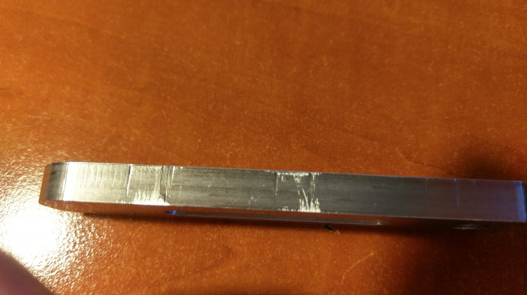

    Hi Kevon,
    My settings on C beam was as follows
    RPM 13000
    DOC 0.38 mm
    feed rate about 700 mm/ min
    3mm O-Flute by Amana tools
    Plange rate: 70 mm/min
    Don't like the cut finish at all, and no shine mirror, just scratched matte surface
    I would consider it acceptable if I had not seen how aluminum cut looks coming out of big milling machines. It like real mirror :)

    I forgot to mention that I occasionally sprayed "Ultra Lube" (from Home Depot) as a lubricant and routinely removed chips by vacuum. That picture above was also made with a conventional cut direction (NOT climb). From everything I've read and from my own experience. Chip removal IS one of the most, if not the most important part of finish quality in aluminum. If you don't clear the chips, they just sit there and are either recut or welded back to the cutter or aluminum. That's less cutting being done overall AND with a much worse cutting edge. You can see the difference in my before and after cut quality in the same picture I posted.

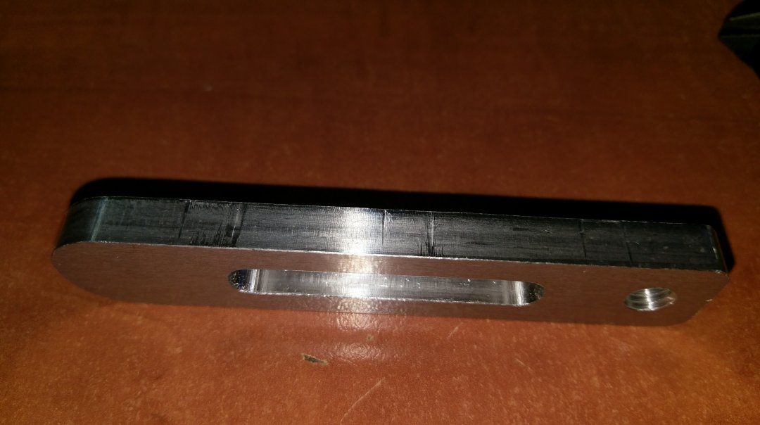

    You cant compare Big milling machine to a cnc router. CNC routers will never be as rigid as a Hass or a Tormach. The finish is mostly result from vibrations i am guessing and deflection which evry machine has even bits have deflection. Try mybe with a stub end mill shorter the better.
    Also use finishing pass with 3 flute end mill with high helix. In fusion 360(dont know how it is in your cam software) i usualy use contour with stock to leave 0.1mm and then another contour with no stock to leave which minimises deflection which couses bad finish.
    Today i made a clamp which made kinda best result i got so far with a O-Flute 1/8" mill with 800mm/s 0.25mm DOC at 19000RPM Roughing and 0.5 DOC finish:
    You can see marks where tabs were made , i'm not really sure why it made them .

    I clearly understand, that the C beam machine in comparison with some professional big milling machines is like a waving flag in terms of stability.
    But I thought by mistake, that the right understanding of the limitation of cnc router and make appropriate steps of overcoming this limitations could be a key for quality cutting.
    In another word, just imagine that You have Porsche Panamera and I have Fiat Cinquecento and we both drive our cars from Munich to Frankfurt (why Germany? because there are no speed limits on highway there) to attend football match of world cup final. You drive 300 km/h, I 100 km/h, You drive with more comfort then I and are more fresh at the end of journey and etc. BUT ! We both will reach our destination and our goal , never mind that I will spent 3 times more, will more tired and etc. We result ( why we are driving to Frankfurt) will be the same for both of us.
    Unfortunately, seems this do not work in the world of cnc machines. If You have Tormach You will cut 3mm DOC, 2000mm/min , 2" 4 flute end mill and will finish the part in 10 minutes. I, with my C beam , taking into account all its limits, will choose much more small DOC, much more lower feer rate, 1 flute end mill 1/8" and make the same part 55 minutes.
    BUT! Even taking into account C beam machine limitations I will never reach You quality on Tormach. ( I think even Tormach has it's limits).
    I think You guys understand what I mean and what I would like to understand for myself: that even concerning all limitations of small cnc C beam machine and choosing all appropriate parameters, I can not get the result of big machine and the best possible quality will be that on the pictures above.
