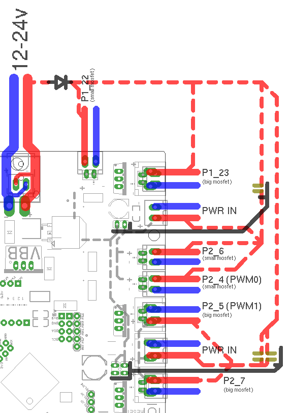

  25. alar
    alar New
    Nov 28, 2015
    Val, Greg, You seem to have good knowledge of the smoothieboard setup so I'mhoping you might be able to make a suggestion ( I'm not trying to hijack the thread) My son and I have built the physical parts of our printer, and are trying to install the smoothie board. We are stuck at the wiring layout where they suggest directly running pos+ power to each of the mosfets. They also show that a diode needs to be the pos+ line (to left part of the image near the 12-24v inputs) . In all my reading I have found no real indication of the proper type or size for the diode they suggest be placed inline, at the VBB (a notation about the fan section shows 2 small 1a ones to install behind fan mosfets, but that is all). Is something like a # 1N2128A .. 50v 60A Power silicone rectifier diode the right kind? do I need to worry about any voltage drop? smoothieboard wire.png diode.jpg Thanks,

  28. Val Cocora
    Val Cocora Veteran
    May 19, 2014
    172
    27
    hi alar,
    you give me too much credit with regards to the smoothieboard.
    as i was saying in my previous post, i have a lot of help with the electronics from my associate. i regret i cannot help you myself with the technical question you posted, but please be advised i connected my smoothie to a windows 8 samsung tablet via usb port, thus solving the power supplying issue to the board itself. while this may not be a permanent solution if one wants to run the printer independently via sd card, it does help greatly in the incipient phase of fine tuning and adjusting the machine, where one needs access to configuration parameters, manual control, etc, via a computer interface, not to mention it is the quickest shortcut for an electronics ignoramus like me.
    however, since your question should be answered, may i suggest you contact arthur wolf, the inventor of smoothieboard?
    his email is wolf.arthur@gmail.com, and, obviously, he is the most knowledgeable person in the world to help you, he IS smoothieboard, and a very nice guy who always helps the users of his products.
  29. alar
    alar New
    Nov 28, 2015
    Thanks for the info Val. Yesterday I had actually posted the question to Arthur because his name showed up a lot on the smoothieboard forum, I didn't know he was the creator. I haven't heard back yet but I figure he's at CES so it may be a few more days till I get his answer. We are using the sub to program and 5v. The diodes were
