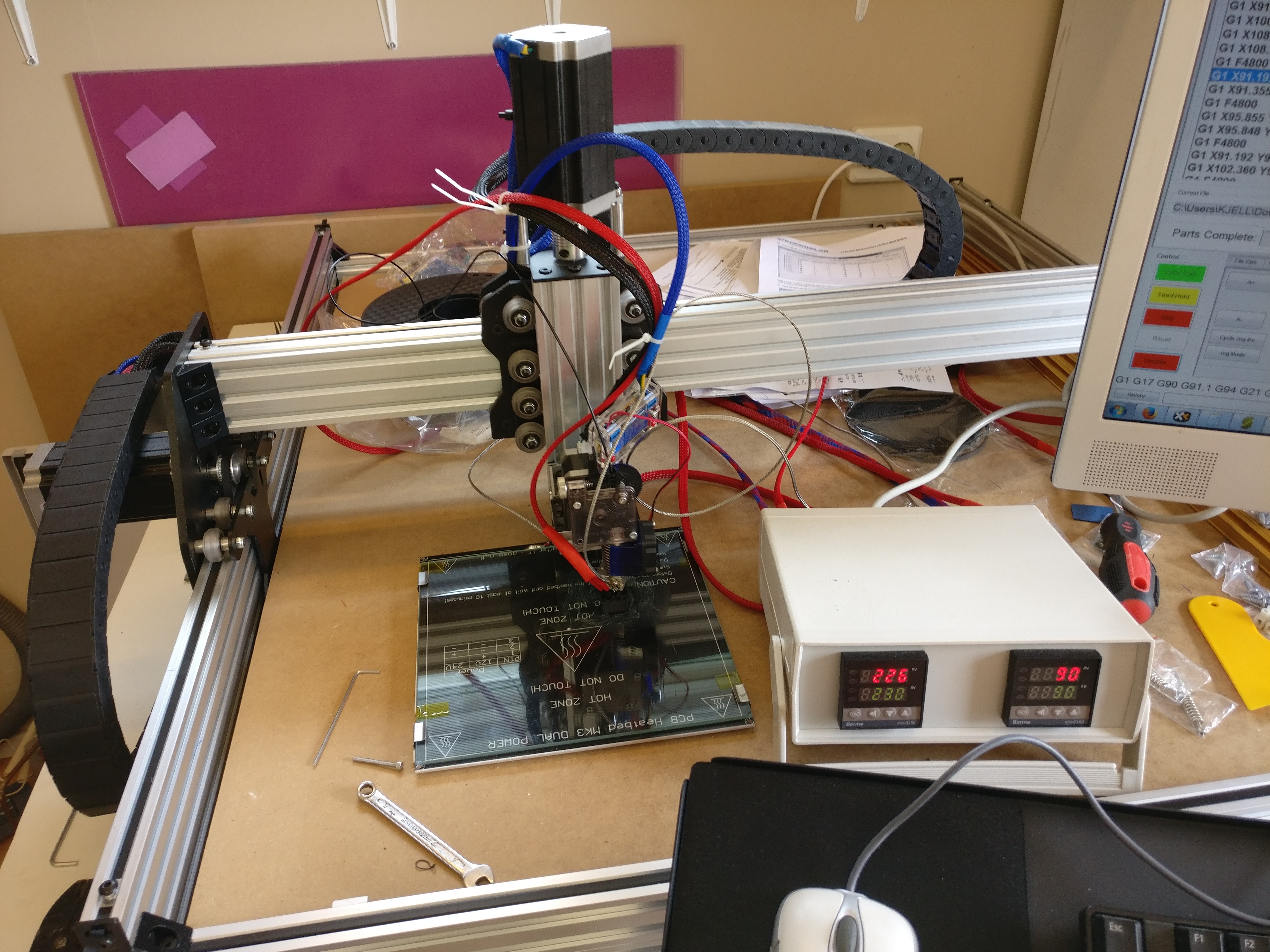

    Realizing some parts needed for the router is better done with a 3D printer I bought some stuff from China. The picture is from the first test-run before
    printing the stuff needed for the 3D printer, most needed is a stand for the filament. But since I need to get the family hooked on my machine I did print a pokemon to my 4-year old son first, that gave me a complete Sunday working on my machine :D

    Nice build, Kjell. I like the repurposing to use as a 3D printer. Machines making parts to make themselves better..... that's scary:nailbite: I look forward to more updates.
