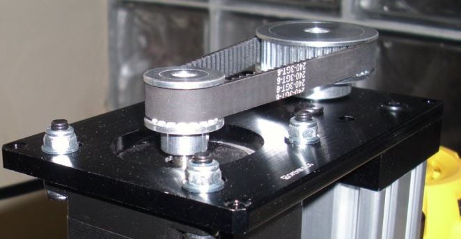

    700
    Awesome, Those are the same mods to the Z-axis I am planning ( belt reduction and double wide plate. ) Looks like it came out great; we are running the same router to boot.. Can not wait to place my next order with the PS. :thumbsup: Thanks for sharing.
    Paul Stoller likes this.
  3. Moag

    Nice enhancements. A few questions:
    1) what size spacers are you using with the mini v wheels in the top portion of the plate sandwich?
    2) Are you using this setup to the belt reduction?
    GT3 20 tooth pulley, 6mm belt width:
    GT3 Timing Pulley - 20 Tooth
    GT3 40 tooth pulley, 6mm belt width:
    Where did you source yours? Doesn't look like the OpenBuilds store has them. I found this, GT Pulleys (GT2 and GT3)
    240mm GT3 6mm wide belt
    Closest I could find... 231 GT3 6 round timing bel 231mm length GT3 6mm width 5pcs free shipping-in Transmission Belts from Industry & Business on Aliexpress.com | Alibaba Group
    3) Do you think using "high torque" 9mm wide belts would be beneficial?

    It looks like that's the right parts for the pulley setup. I cant find them on the openbuilds US site which is a shame since I saw them on there not long ago. It looks like the Mexico site has the parts though.
    I looked on ebay for a reduction setup and there are some but only in GT2 belts. I'd imagine the GT2 is fine for a reduction setup but I'm not sure.
    gt3 reduction belt | eBay
    If you go that way it looks like you'll have to request a belt for about a 45-55mm wheelbase, if anyone can confirm that it'd be great.
    Edit:
    HTD3M 50T 25T Belt Width 10mm Timing Pulley Belt set kit Reduction Ratio 2:1
    That seems to be a really good option if you can't get the parts from Openbuilds. 10mm belt, 3mm tooth (GT3?) and a large motor pulley for a lot of tooth engagement.

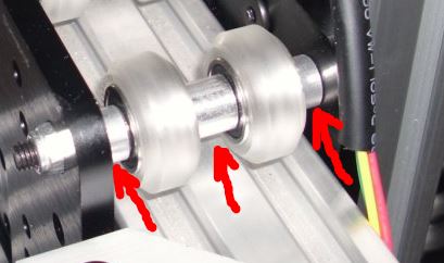

    6mm 9mm 6mm spacers. those are not mini v wheels nut standard v wheels. if that is a

    Hello @EvanBruner,
    It looks like the OpenBuilds HQ has pulled the plates from the store for now to add some improvements. OpenBuilds Mexico has indeed only 2 in stock at the moment. I would wait a bit till the plate is released again as I don't see GT2 / 2GT as an option, MXL can be found as 2.93mm (0.115") pitch, close to 3mm and works well.
    The belt and pulleys are sold by OpenBuilds, it's just the plate that is missing from the store.
    @Dave420 is right about the spacers and some of the 6mm spacers you already have.

    Does anyone have any tips for adjusting their eccentrics on sandwiched gantry plates? I can only seem to get the row of wheels farthest from the z axis tightened with the eccentrics, the rest are kinda floating. Thanks!
  20. Carl Feniak
    Carl Feniak Journeyman
    Mar 18, 2014
    654
    246
    Hmm, 3D print a double ended wrench so you can tension both at the same time? Else two wrenchs, hex key, and nut driver all at once! 4 handed operation.

    Darn, just a "few" chips. I'm about the order the collet like you have, and I'll go with those end-mills as well. Sure it will take months to have that shipped to Mexico. Next week I hope to get the table plate in, 3/8" with treated holes every 30mm. I'm also still waiting for the 100nF and 10k resistors for the switches. In the mean time I'm working on a "low cost" router, today I'll draw the cable chain. All will be with OpenBuilds parts except the cable chain.
    @EvanBruner, use a mirror and always turn the laser-marked side pointing outwards of the X-Z body ;). The eccentric spacers will not turn when you tighten the nut.

    547
    So what happened to the belt reduction parts in the OB store? They are not there anymore...
  25. Ronald van Arkel
    May 7, 2014
    472
    245
    Hello @Metalguru,
    Just contact them by mail, they have them in stock, it's SKU 872.
    I'll read trough your build later, doing some precise drag chain drawing (18x25 chain). Did you by the Igus or any other chain?

    Only the plate is gone, the rest should be there:
    GT3 Timing Pulley - 20 Tooth - High Torque Series
    and... what the... Just write them tomorrow, I have no clue why the parts are not there at the moment.
