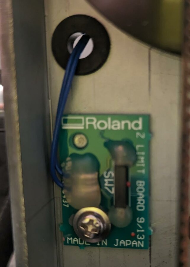

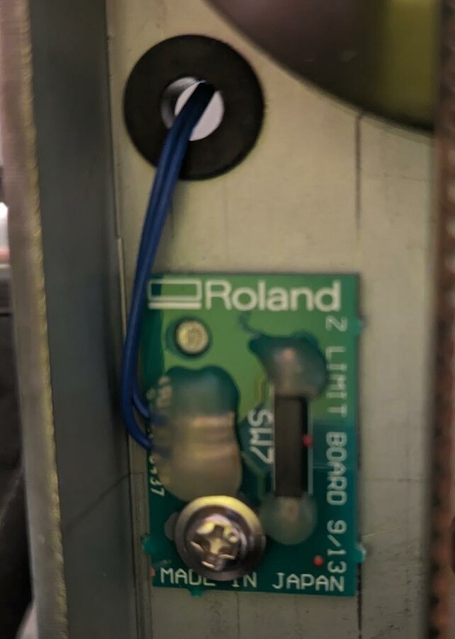

    I have found the wiring for the X & Y end stops. Which oddly enough Look to be Reed Switches:
    The X and Y home in the right places (X=0, Y=0) to re-use the reed switches, so for now intending to re-use'em. The Z limit isn't working so Im doing a lot of continuity testing.
