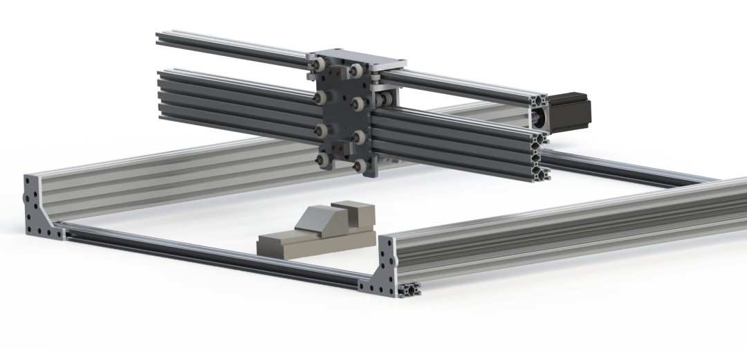

    Well after a lot of decisions and trial an error, according to solidworks these are the first glimpses of what the X Axis should look like if I get a day to myself to cut them.

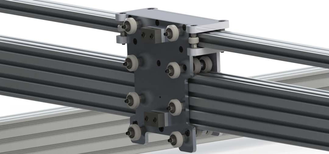

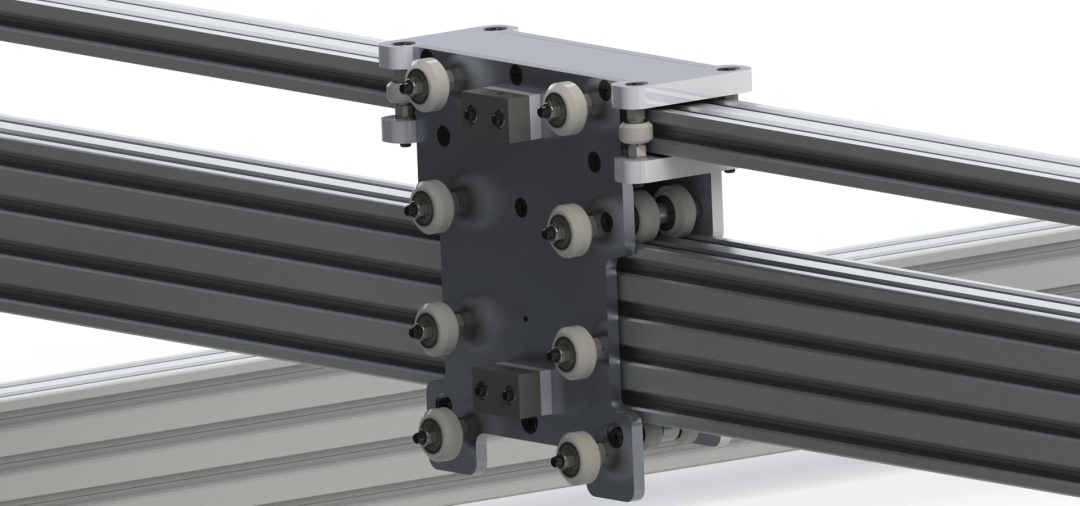

    One thing I have noticed with my OX and the weight of my spindle is just how much leverage/deflection there is within the X, although the wheels hold the weight well when pressure is applied from top I wanted to take some of the side strain away from the wheels caused by the front loaded weight, if that makes sense. It has also allowed me to space the wheels out further and might add some mini`s in the center.

    This is pretty much what I'm going to do with my next machine. It's a simple, but positive way, to remove the spindle twist pivot point. I will probably put a little more distance between the C Beam and the horizontal beam and that will mean an increase in the size of the Spindle mounting plate, height wise, and most likely an increase in the length of the screw, but this should be no problem.
    As I've said before, I plan to have yet another beam about 6" higher to attach my vac pipe to, to relieve stress on the Spindle point where the vac will be attached.

    Finally finished the X axis and will upload the updated files shortly.
