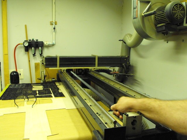

    Hello, I am building a 1500mm x 1000mm laser cutter and am having some problems with excessive noise/ vibration during slower moves. I have tried different micro stepping configurations but this doesn't seem to help. The longer Y axis with two motors has much more noise than the X.
    Any suggestions?
    I have attached 3 videos.
    Y moving slowly and making lots of vibration
    Y moving fast and sounding much better
    X moving slowly and sounding alright

    I would say
    1) Theres a lot of whipping on those leadscrews, get them in tension
    2) The seperate Y drives are a house fire waiting to happen with a flying optics laser - consider (seriously) re-engineering to mechanically link the two sides (driveshaft or link belts, etc) - if one motor skips mid-job, your gantry goes skew. Laser beam misses mirror 2 or 3 because the off angle its running at now, and aims out directly at the nearest flammable surface. Or an eye. And yes, it happens. A certain Makerspace in Durban lighting a next door clothing cubicle in an event hall on fire - I was there
    3) Enclose the laser
    Sorry got off track with the safety issues
    Sounds like bad drivers? What are you running? Pics doesn't show clearly? Consider a BlackBox docs:blackbox:startc [OpenBuilds Documentation]

    Thanks for the input. I have tension nuts and thrust bearings for the screws. My couplers are slipping when I put sufficient tension on the screws. This is another issue that I'm currently working on.
    I'll think about your second point. I have experimented with the gantry being misaligned and this does not cause the laser to miss the final optic. The mirror on the gantry is fixed to the gantry so it would rotate along with the gantry beam if twisted.
    I will be enclosing the laser after the mechanical issues are sorted out.

    Also sounds like a driver issue, being underpowered - should spin a tensioned leadscrew with ease
    Another thing to consider, did you check the Coil Voltage rating of your motors - if they are not 3v motors, you'll have a hard time too.
    But as the Entry angle of mirror 2 is fixed, the error on the exit is twice that of the gantry - that causes it to shoot past the mirror mount. As its a mirror, the beam bounces off at the same angle it came in, and in this case is thus wider than when its square. Trust me, I have seen it happen, and I may be the most annoying advocate for locking the two together there is, but it really is a super dangerous (and very likely) failure mode.

    The problem isn't the motor torque. The screw is pulled linearly out of the motor coupler when I pre tension the screw.
    I will heed your advice. Thank you for bringing it up. I haven't had any issues at all with my leadscrew converted router table but I see where it could be a bit more of an issue here. Perhaps I could use a low power laser emitter and detector which when no longer aligned, triggers an emergency stop.

    There's a lot of red flags. The method of motion just doesn't match the machine purpose.
    Aside from the glaring safety issues...
    Do you plan on adding some sort of bed?
    What about ventilation?
    If you have the crews tensioned from the outside of the plates, it shouldn't be pulling through.
    Your router doesn't depend on having a beam hit 3 points before hitting the laser head. Unless the point of contact on the mirror is the pivot point when the machines goes out of whack, it WILL deviate.

    It is not. I did just realize one of my problems though. I only have a tension nut on one side of each screw. The other side has been held in tension by the motor coupler but I think it will be better for the coupler to only be handling the rotational force.

    Your building a cutting laser only. Your leadscrews will be whipping going the speed you need to any serious engraving work. You would be a lot better off using belts in my opinion.
    I will also agree with what @Peter Van Der Walt said about enclosing it before you even try firing the laser and get rid of the second motor on the Y axis. I can visualize one of the motor missing a step and the laser beam going right across your belly and burning you and catching your clothes on fire.
    Because of the size, I really don't think your table it up to the task of keeping all the mirrors aligned without having to do a realignment every time you go to use it. Just a change in the humidity will throw them all out of wack. Even if one corner moves a 1/16", you'll have to do a realignment and keeping the beam centered down the middle of the tube on the head will be difficult. I've read about guys that have China made cabinet lasers on roll around carts that have to do a realignments every time they move them.
    These are all my opinion, but I do want you to be safe. There has been a lot of costly fires started by laser cutters/engravers.

    I tightened the screws by putting tension nuts and thrust bearings on the motor side. I also 3D printed motor mounts to allow coupling the motors.The whipping looks a lot better and the sound is actually a bit better but still way louder than it should be.
    This is making me more certain that the problem is the motor drivers like previously suggested. They are "Microstepping" but still a lot of cogging and resonance is still occurring.

    Damm, that's loud. Sound like you have too much amperage and trying overcome a lot of friction. Adjust your amperage as low as the driver will go, and then start increasing it till you have the motor running nice smooth without missing steps. Also see if the leadscrews turn freely.

    I just went back and looked at the photo of the drivers and you do have the amperage set low, so I don't think it that. The 2 Y axis drivers look to be set at 1600 steps and the X axis driver looks to be set at 400 steps.
    Really need this information to give you more suggestions to check

    Ok so those are actually pretty OK drivers.
    What controller and Motors are you using?
    Paste your Grbl Settings
  26. DeltaModworks
    Oct 9, 2019
    16
    3 x 23HS8430B stepper motor 76mm 270oz-in dual shaft
    SainSmart GRBL usb controller: SainSmart 3-Axis GRBL USB Driver Controller Board DIY Engraver Control Board for GRBL - - Amazon.com
    Raspberry pi 4b running UGS
    GRBL Settings:

    Can you turn the screws by hand? I can turn mine by hand with no problem at all. It turns smooth and easy and moves the gantry with little effort from me.

    16
    Yes, they move fine by hand.
