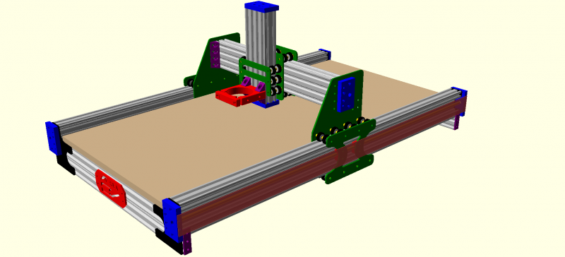

    Well tonight I designed and printed a prototype of my first part. The part is a "Y End Plate". You will need 4 of these for the printer. I will post the .STL file for now. I used Solidworks for the first time, its not too bad.

    Okay, I have now proven that my Endplate will now work. I have printed out a bunch of pieces with my 3D printer and have assembled them. I now that I will also need two double corner brackets , one three hole plate and one corner connector bracket. Let me know if everyone things this will be sturdy enough for the corners.

    That's crazy. I love it. Being a designer and having to color code everthing to help convey intent, I love the fact you printed everything in different colors. Great model Steve. I think you should build and work out any further kinks now.

    Well I had some time again to design the "Y Inside Plate". I don't know if I have everything on the plate but I will revisit it again tomorrow night. This plate should allow a "X" C-beam to mount to it and have the normal C-Beam End posts tie into it.

    Here is the "Y Outside Plate". I also added a picture of how the two pices would kind of line up as well. Also, the STL file is included.

    I suggest that you may extend it to be near your X beam to prevent stuff to get on your wheel or add holes to be able to add a brush (hard to find)
  15. Steven Bloom
    Steven Bloom Journeyman
    Dec 18, 2014
    194
    105
    Not sure what you saying by extent it near X Beam. Enclosed is a new picture. I was hoping that with this design there would be a minimum amount of dust near the wheels.

    I am now getting closer. Tonight I will start on the plates that will travel across the X axis and hold the Z. This part will be tough for me.

    The 20*40mm V-Slot at the back, move it as far to the edge of the back of the side plates, put the 90º corners to the front of it; this helps a bit with sturdiness. Another tip: use 2 Acme blocks on each axis, put them apart as far as possible and put them in a distance of steps of 8 mm, hart to hart. This will reduce vibration and slack. Looking good!

    More Changes . Moved the V-Slot back and now can use two acme blocks per side.

    I am done with work for the night but I got a chance to work on the X/Z Plates. It is starting to come together.

    You'll gain some X travel if you put the big Y plates on the outside of the C-Beams, but as I said earlier, you'll have to modify a little bit your inside plates to protect your wheels/belt.
  22. Steven Bloom
    Dec 18, 2014
    194
    105
    Actually the X is 500mm. It will still travel the same distance either way. The only way to make the trave longer is to decrease the size of the gantry that is holding the spindle or increase the X beam
  23. dddman
    dddman Journeyman
    Mar 2, 2014
    468
    187
    True, you'll just optimize the footprint the other way.

    Almost done designing the last part of the Z Axis. But I have a question ??? What is the normal amount of room betwwn the top of a wood board and the cutter. I think I can cut something up to 40mm thick.
    Is that enough room ?? I have no idea what the standard is .
    Thanks Steven
  25. Joe Santarsiero
    Joe Santarsiero OB addict
    Oct 30, 2014
    902
    196
    I think that depends on what you cut and what precision you expect. closer to the gantry means better precision. The further out you hang that thing in a cut the more torque that's translated to the gantry and the more doc plays a part. The other problem to consider is that bits and drills come in different lengths. So, you have to factor that in as well. 40mm is good, but do you need that much of a gap? on that note, You can throw in more or less spoil board for adjustment.

    Ok, I now am pretty much done drawing. I might have to make the Y Plates a little higher. I don't know because I need to see home much clearance I really have. Now I need to buy some stuff.

    Ok, did a little more cleaning up. Enclosed is a new pic and a complete zip file of the OpenSCAD rendering and all the associated .STL Files. Some of the .STL files are my design and some are .STL files that are Openbuilds.
