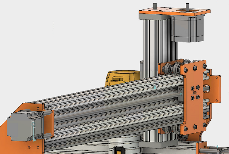

    Brian Popp published a new build:
    Read more about this build...

    Nice Fusion Models :)

    Hello Brian,
    ...I like the changes to the y plates. Will you be publishing the 3D files of the build? I would be very much interested (particularly in the y-plates - bec. I haven't had the time to learn the ropes of a 3D package yet).
    cheers, Fred
    ...Thanks a lot for uploading the files, it is much appreciated!

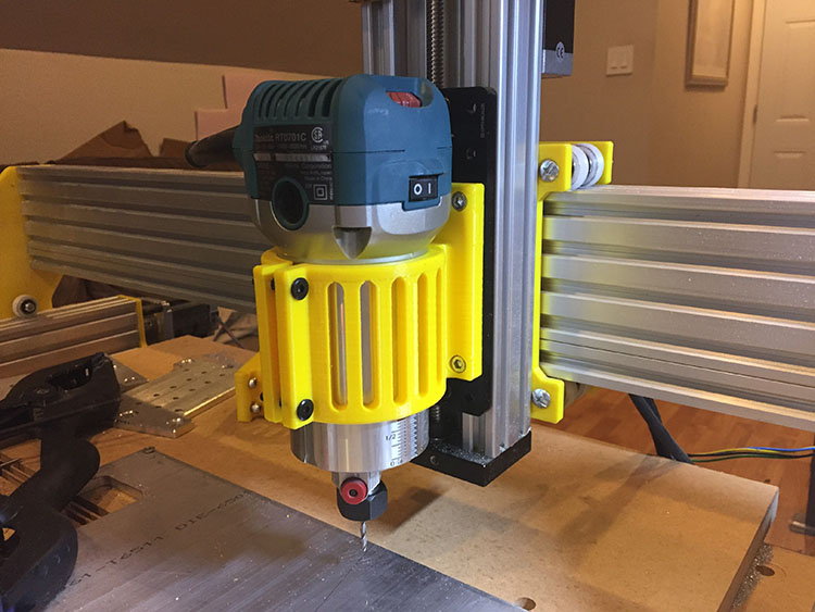

    I probably wouldn't try to launch a space shuttle with it, but it's surprisingly rigid and accurate. I haven't done any in depth testing with machining tools or anything (I'm obviously very new to this), but the few parts I've made fit perfectly. I suspect that it will eventually tear itself apart, though, so I'm very quickly trying to get all my plates cut out without putting the machine under too much stress. For this plate I used .3mm cut depth, around 250mm/min (very slow), and I think around 15-18k RPM (around 2 on my Makita router).This is 1/4" 6061 aluminum.
    I do have two problems right now that I'm trying to work through. I don't think they are plate related, but they might be. The first is that my Z axis seems to plunge inconsistently. The bed is relatively level and the gantry is level with it, but it consistently cuts deeper the further right on the X axis I go. Inevitably if I put my z axis on the top of the stock, set zero, home, and then return to zero, my cutter try to dig 1-2mm into the plate. It almost never goes back to exactly the same z position (the other two axis are spot-on).
    The other problem is that I'm getting a lot of resonance at high RPMs. I tried to cut some MDF last night and it was mind-piercing. I think this is caused by looseness in my Z axis gantry, but when I tighten the mini v-wheels down, the wheels stop rolling and instead drag. This causes a stutter since the weight of the router is putting uneven forces on the gantry plate.
    The CBeam design with the mini wheels for the z axis is kind of clever, but so far I'm not really a fan. It takes up too much space and it really seems unbalanced and has a lot of deflection. I'm definitely going to spend some time trying to improve it.. either by fixing my mistakes or redesigning it entirely.

    No, the support rail goes underneath the X axis cbeam (slightly darker rail in the shot below):
    I joined the two together with blind joints. I honestly don't know if this extra reinforcement is even required. Those C-Beams are already pretty beefy. I'd talk to one of the guys that have built 1000mm CBeam machines and ask if they've noticed any deflection in the middle. I honestly doubt it, but for $15 bucks and no negative impact to the design, I thought it was easily worth it. It also has the added advantage of moving the wheels further apart, adding a little extra weight, and increasing the surface area where it joins to the Z axis cbeam.
    Just throwing this out there, but what might be interesting would be to move the CBeam down to where I have the 20x40, and then replace the 20x40 with a 20x60 and move it above the cbeam. This would allow you to use 3 rows of wheels instead of two and that would definitely have a positive impact on reducing z axis torquing. You could also put a 20x20 next to the bottom cbeam to allow for 9 wheels on the bottom. I'll mock that up when I get home tonight and upload some more plates if it looks like it would work out.
    By the way, I mentioned earlier that my 3d printed wheels didn't work out. That's not entirely true. I am using using 3d printed wheels (polycarbonate) for the large wheels and it seems to be working fine. You can see them above in the Z axis gantry shot.

    Justin, I beefed up the design a little bit and it's actually working much better. Aluminum would be better, but so far it's taken whatever I've thrown at it:
    I did another plate last night and got no chatter and was able to double my cutting speeds (450mm/min+). Halfway through I started boosting the feed speed to 200% and didn't seem to have any issues. I'm going to experiment a little more tonight and see how much faster I can go.
    You can see I have my router at the top and I'm having to cut way down at the bottom of the Z axis, though. When I rebuild the X/Z axis, I'm going to mount the Z axis lower so that I get more range and can mount the router further down. It would be much better if I could choke up closer to the bit.
