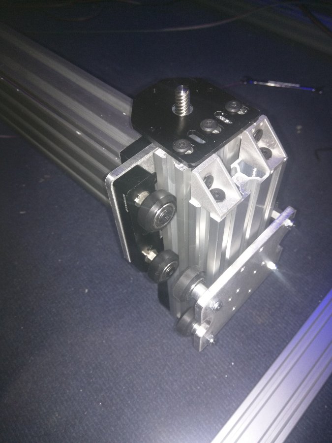

  9. mytechno3d
    mytechno3d Veteran
    Dec 15, 2013
    109
    311
    Aluminium plates were cut with my other plasma cutting table .
    Cutting aluminium with plasma work fine but the results are not as good as with steel .
    To be continued ...

  10. Metalguru
    Metalguru Veteran
    Dec 29, 2015
    752
    547
    I like those custom side plates. Going to be a bit difficult to adjust your eccentrics, no?
    Can't wait to see it in action...
  11. mytechno3d
    mytechno3d Veteran
    Dec 15, 2013
    109
    311
    Adjust the eccentrics is not a problem because the 2 custom plates are mount after the adjustement of the 2 carriers of the Y axis .
    But if something go wrong or move , effectively , you will have to remove the 2 custom plates to re-adjust the eccentrics .

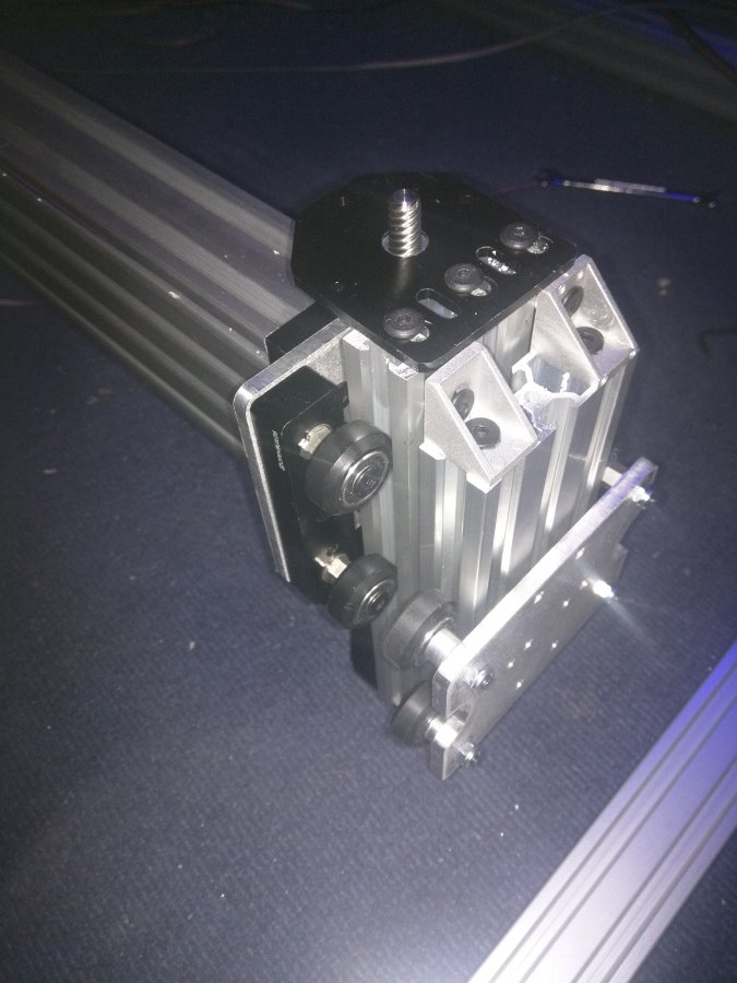

    Picture of the floating head at the end of the arm :

    Why do you need 2 sets of carriages for the torch? Isn't that a lot of extra weight?
    MG
  15. mytechno3d
    mytechno3d Veteran
    Dec 15, 2013
    109
    311
    I use this kind of assembly to detect the sheet of steel and set the "Zero" of my Z axis .
    You can see a full assembled floating head on this picture ( this is my other cutting table )
    When the torch is on the sheet of steel , the second carriage move up to the endstop .
    An offset is set in Mach3 , this is how i set to 0 my z axis .
    The extra weight is not really big .
    Another way to do this could be using an omic torch sensor on the torch itself ( i will explore this solution .. )
  16. Metalguru
    Metalguru Veteran
    Dec 29, 2015
    752
    547
    Ah, I see. Seems a bit complicated, you could just use an inductive proximity sensor or even just a microswitch to detect the material to be cut...

  17. mytechno3d
    mytechno3d Veteran
    Dec 15, 2013
    109
    311
    To keep a precise "zeroing" of the Z axis , the touching point must be as close as possible of the torch .
    On my last try with an inductive sensor or with a simple endstop , the life expectancy of the sensor was very limited .
    This is why i use this kind of solution .
    Extra weight is around 200g .

  18. Metalguru
    Metalguru Veteran
    Dec 29, 2015
    752
    547
    So, I'm not clear on how this works. It looks like there is a microswitch on your outside carriage, do you lower the inside carriage down until the torch contacts the work, and lifts the second floating carriage until the microswitch contacts? Then lift the inside carrage a fixed amount to set the torch height?
    Why would the sensor life of an inductive sensor be limited? Does the electrical field from the torch affect it? Spatter? Wear and tear from contacting the table?
    Some photos with the torch attached might be helpful. A video of it in action would be even better...
