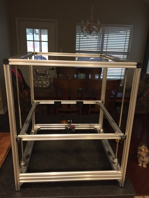

    Couple pictures of the build so far. Waiting for parts to come in still.

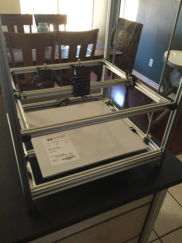

  7. JOSH.PIERCE
    Aug 17, 2015
    18
    27
    Thanks Larry.
    I am hoping that because the build platform is fixed the nema17 will work since i am only lifting the gantry. The ones i got are 84 oz/in, so i am hoping they will be enough for the Z. Time will tell on that one, if not i will step it up to a 23.
    Got some more work done on it over the weekend and finally got some pictures. Build plate is just sat there for my amusement. Will be making some brackets to use for leveling and raise it off the base for my heater to attach to the bottom.
    Still waiting on some key parts to come in, hopefully they will be here soon.

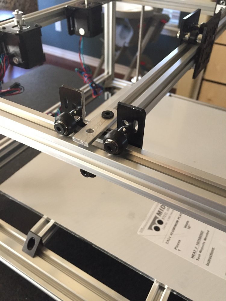

  19. JOSH.PIERCE
    Aug 17, 2015
    18
    27
    Got all my parts in last week while i was out of town. Got more done than i have pictures of, but am out of town again. Got the Z all set up and working. The nema17 was plenty to move this axis and I also uses a 1:2 gearing to drive the screws 20t to 40t (stole that from your build tom).
    Hooked up the belts for the gantry and got it moving also. Took it apart to do run the wires a little better temporarily until i can print some cable management and misc parts to improve the design. I think I will accomplish my goal of getting it printing with only off the shelf parts that could be modified and a few trips to the home store.
    Will complete the wiring when i get home thurs and hopefully get a first print.
